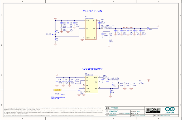

I'm trying to power my Giga with 5V coming out of LMR33630 buck converter but the Vin pin only has range from 6V-24V. Do you guys know if I can route this 5V power somewhere (I know I can power it with USB from PC but I'm trying to make the PCB power the GIGA).. thx :slight_smile:

Only power the board with external DC voltage via VIN and with a voltage that is in the specified input range of "Input voltage (VIN) 6-24V".
This is from one of the Arduino Giga R1 WiFi Schematics, it may be possible but I am not sure what will happen to the buck converter chip. Best advice is from @Dozie , that way your warranty is still valid.
The power tree in the datasheet suggests you should be able to provide 5v to either the USB-C or 5v rail. I would ask @Dozie to reconfirm, but agree with @gilshultz if you want to play it safe.

The 5V rail is OUTPUT only. Use VIN, the buck is designed for up to 22V
Just a question, i stumbled on this topic through research for another thread. (and it's still open) But doesn't the schematic show that the USB port does directly power the 5v rail through a Schottky diode ? That should mean that it is safe to use. The buck converter is only enabled when power is applied to Vin.
