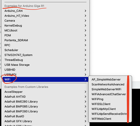

I installed Arduino IDE 2.3.6 on my Windows 11. I installed "Arduino Mbed OS Giga boards" ver 4.3.1.
When I connect my Giga to USB I see it on COM20... but I just see it as "Arduino Giga R1", not "Arduino Giga R1 Wifi":
I try via ChatGPT to get this to work. It says I remove the library, delete some files and try to installed it again. But it´s still "Arduino Giga R1". Everytime I says, "I can´t see ´GIGA R1 WiFi´" it´s saying I need to remove and install again to get I2S to work. :frowning:
  1. Should I see "Arduino GIGA R1 Wifi" in borads manager? If I include "<WiFi.h>" I got no error.
  2. How can I get <I2S.h> to work on my Arduino GIGA? What do I need to install?
Anyone including an AI that tells you to re-install something is just wasting your time. If you are unsure, load a sample WiFi sketch from among the following

The board package for the Giga contains this line which is what you will see in the IDE: giga.name=Arduino Giga R1. So what you see is correct.

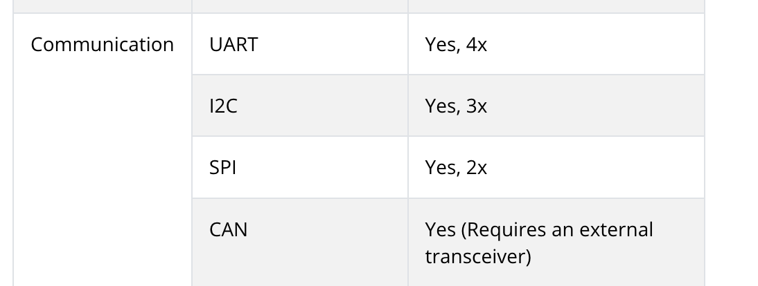

What makes you think the Giga has I2S? I don't see it listed in the specs

Don't forget the Giga has SPI, in fact two of them.
if you look at the STM32H747xI/G datasheet it does mention I2S

It´s included on the processor, but not implemented in GIGA. It says also 6xSPI, but GIGA only had two of them supported SPI1 and SPI5. :frowning:
