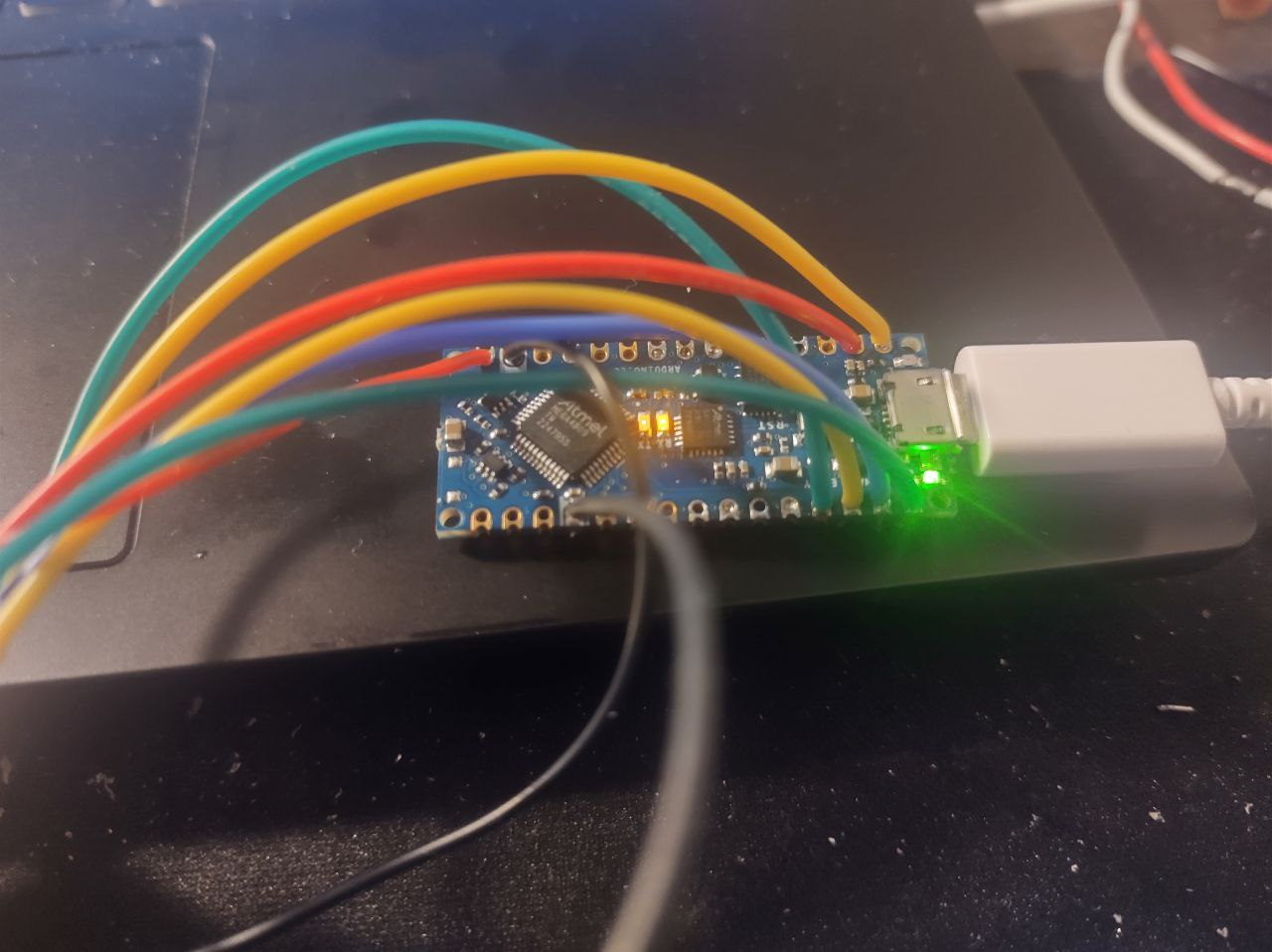

Hi, I need your help! I have 2 Arduino Nano Every boards. I connected NRF24 module to the first board, uploaded my sketch and everything worked fine:
But for some reason, Arduino IDE doesn't see my second board even if I use the same port:
When I switched back to the first board - everything worked fine again.
Also I noticed that these two orange lights are turned on on the second board:
and I don't know if that means anything but I left my second arduino board plugged into my laptop for about an hour and when I tried to touch it it was extremely hot.
Is there something wrong with Arduino module itself? Thank you in advance!
No, there's probably something wrong with your connections, but without a schematic, we won't be able to tell.

second board to 9V battery:
VIN-> toggle switch -> 9V
GND -> GND
second board to NRF24:
GND -> GND
3.3V -> VCC
D9 -> CE
D10 -> CSN
D13 -> SCK
D11 -> MOSI
D12 -> MISO
disconnected battery and switch but nothing has changed

I noticed that the second board starts getting hot soonly after I connect it to the laptop
It sounds like a bad card. Where did You buy it?
Did You make sure they use different USB ports?
  1. What did get extremely hot?
  2. Did you test the board before you soldered the wires to it?
  3. Make sure that you don't have caused any shorts with the soldering.
Disconnect everything except for USB and check.
Your board is probably dead by now .
As said , You should try connecting just the bare board via USB . It will probably be on a different port .
If it got hot then there is a fault or a previous fault has damaged it .
When starting project Always test the bare board first will a simple sketch , then you will know if it works ok.
Most destroyed Arduino are caused by wiring errors or short.
A good tip : When starting project Always test the bare board first with a simple sketch , then you will know if it works ok.
Try and stick with wiring using the same colour scheme - you have black as 0v from the battery then colours change - easy to then destroy a board with the wrong connection.
Most destroyed Arduino are caused by wiring errors or shorts
