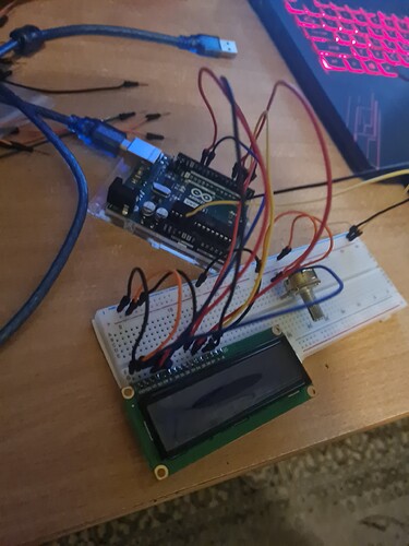

I am a complete newbie and im doing a project for my studies.
I have hooked up the arduino with lcd and it seems that everything is hooked up correctly.
The lcd lights up and I can change the contrast with the potenciometer. However, whenever I try to print the hello world nothing appears. Also, I heard something about squares appearing when the lcd is hooked up and I dont see any squares as well.
Here is the code

I am also adding some screenshots of what the setup looks like.
Is there any specific wires which are in charge of this? Maybe I should try to wiggle or replace them but which ones tho?

How can you see the change in contrast if the squares do not show up?
Try this: disconnect everything except the ground and 5V (Vss and Vdd) from the LCD. Connect the VO pin to ground (disconnect the pot). You should see a line of blocks on the top row of the LCD.
Is this what you see?
I guess you mean like this?
As soon as I removed 2 - 5 arduino pins from the lcd it went black and there is nothing showing up on it
Also by change of contrast I meant that when I turn the pot the screen gets darker or brighter

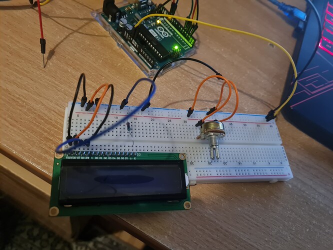

Because I connected everything like that and nothing shows up on my lcd right now.
So I wonder what could this be
Sorry, I should have included to connect the backlight pins, A and K.
A being the resistor and K goes to ground right?
I did this like ssen in photo.
Still not working tho

Yes, the backlight looks to be wired right.
Your breadboard has the split power rails. You need to jumper the split so the whole rails are powered as shown in this image. Sorry, I missed that before. Due to the split the LCD is getting no power.
Yes this fixed it!!
Thank you soo much.
So I assume when I connect everything back it should work fine now? :slight_smile:
If adding the jumpers helps, go ahead connect the rest of the wires and the pot. But be aware that almost all of the LCD tutorials have the wiring of the contrast pot wrong. It is a mistake that has been perpetuated through the years. The right way is to wire the one end of the pot to ground and the wiper (middle terminal) to LCD pin 3 (V0). The other end of the pot is left disconnected. So the pot is a variable resistor. Actually I find that a 1K fixed resistor from ground to Vo gives me satisfactory contrast on virtually every LCD that I have tried.
