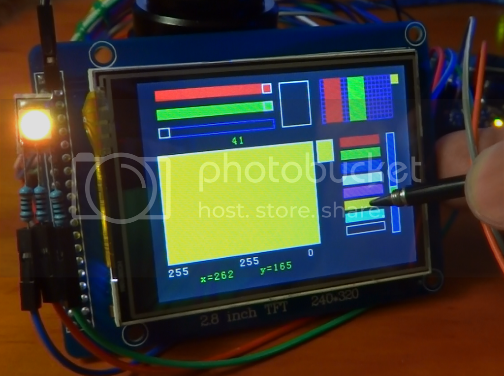

I have a similar TFT on Arduino Due (VCC, RD and LedA to 3.3 V)
Controller: ILI9325D, 16 bits
For UTFT library: UTFT myGLCD(5,38,39,40,41);
Direct wiring on MEGA or Due:
http://www.dimdim.gr/2013/01/3-2-tft-pinout-connection-to-arduino-mega-or-due/

2.I tried connect leda,RD, and Vcc to 3.3 v but it didnt work.
one other thing i want to ask u that what if i connect in series of signal pin with 2 1n4007 diode as you khow each diode is drope .6 v so i can get 5v-1.2v = 3.8 v is it right thing to do ??

Use LED's, They drop 1.8V, so just about on the sweet spot for a TFT. Just make sure the polarity is right. They should be very dimly lit as data passes trought.
