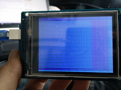

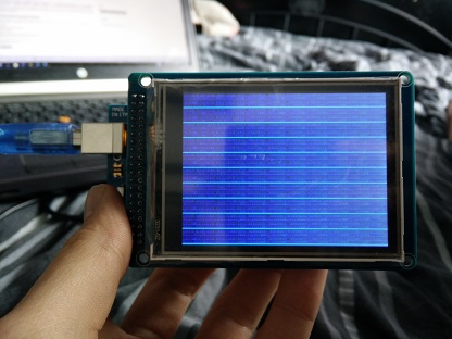

Hello everyone!
I am trying to build an aquarium controller based on the Jarduino project.
To spare you all the unneccessary details:
After using the screen and the arduino fo a few days, loading the modified codes, I started to get screen glitches.
(So, for a few days, this whole setup was working glitch free, exactly as I intended).
In the images attached you can see the glitches happening.
To sum up:
Materials used:
-Arduino Mega 2560
-ITDB02 v1.1 shield
-3.2" TFT from ebay with ILI9341 (16 bit parallel mode is used)
The TFT is plugged in directly into the ITDB02 shield, which is plugged in directly into the Mega.
Codes used:
-First, the Jarduino code, which gave me the glitches after a few days
-Then the examples provided by the UTFT library.
To get the ILI9341 to work, I had to mod the UTFT library, because as of now it does not support ILI9341 in 16 bit parallel mode. However, there are many threads with the solution to this. You need to modify UTFT.cpp so that the resolution of the ILI9327 entry becomes 240x320. Apart from the resolution the ILI9341 and ILI9327 work identically, or so Ive been told.
The strange part is that, once I got these glitches, they disappeared sometimes after restarting, or after having the screen glitch out for a good half hour. So it is really random when the glitches appear, but once they appear they stay on for quite some time.
Solutions tried:
-Different TFT screen
-Resoldering the ITDB02 v1.1
-Checking the ITDB02 v1.1 contacts with multimeter
-USB power
-External 9V power (yes enough amps available for the mega)
-Different library
-Clearing EEPROM
None of these solutions worked. Right now my best guess is my Arduino is broken.
However, the IDE gives no errors, and all the other sketches such as blink or the SD library work just fine.
I have already ordered a new Arduino as a sort of final solution, but do you guys know what causes these glitches? And how to fix it?
Many thanks!

Sorry, I don't know what causes the glitches, especially as it runs just fine for, what? Some days? before the artifacts appear?
Could be overheating of a component.
Could be memory leakage in the code (not necessarily yours, in the LCD driver) causing display corruption.
Does unplugging and replugging it into the power source (not USB/PC) clear the glitches?
Does pressing the reset button on the Arduino clear the glitches?
Dear Ralph
It worked fine for a few days, then the glitches appeared.
Since that moment, the glitches are there 90% of the time.
I do not think it is overheating, since removing power for a day and turning it back on still shows glitches
However, sometimes after a few minutes the glitches disappear, only to come back after a few minutes
Unplugging/replugging does not clear the glitches but it sometimes changes the severety of the glitches.
Pressing the reset button has the same effect: Sometimes the glitches are less severe with even a few readable characters on screen, sometimes the whole screen stayes white, sometimes it looks like the images I included.
I will look into the memory leakage you mentioned.
The example sketch from the UTFT library displays circles and squares, which some runs look fine, some runs they are not distinquishable at all, and some runs only the yellow square shows, and some runs the squares have a few black lines going through them.
I am still not sure what causes this but I hope using another arduino will solve the problem. Sucks though since this one is only a few weeks old.
Mmm. Sounds ominous.
Did the example sketch also work correctly in the beginning? If so, (and now it doesn't) then it does sound a bit like component failure.
That said, I must have tried half a dozen libraries to get my TFT working satisfactorily, some gave me partial results some just gave me junk on the display.
You say you modified (or took a modified version) of a library - is there something going on in there perhaps (but which still doesn't explain how it all worked for several days, glitch-free, unless it is doing something to your TFT that is outside of its specification).
Is the voltage to the TFT correct (eg it expects and gets the 3.3V or 5V or whatever), tested by you on the relevant pins?
Is the soldering (probably originally done by some 9-year child in the Far East, no offense intended) up to scratch? Perhaps a fine soldering iron and a magnifying glass to go over all the joints may elicit success (I fixed a portable TV once by doing this, I was well-chuffed).
Finally you could purchase another, identical one to see if the problem persists (or returns). Or buy a better-supported TFT, that is, with a library that everyone else is using. And controlled by SPI or even slow old I2C rather than umpteen wires directly from the Arduino.
Or, depending on what it is you are displaying, abandon the TFT for a reliable 20 x 4 LCD. Yes, a bit rad I know.I'm just going through all the things I would try before admitting it was a component failure.
Use TFTLCDcyg's modified library.
It is crazy to use "unknown" controller models with UTFT. I would guess that TFTLCDcyg has got correct initialisation for the ILI9341. And it should run glitch-free for weeks on end.
At least you are using a proper Adapter shield. This should give you good electrical connections. I am not so happy with the mechanical robustness.
