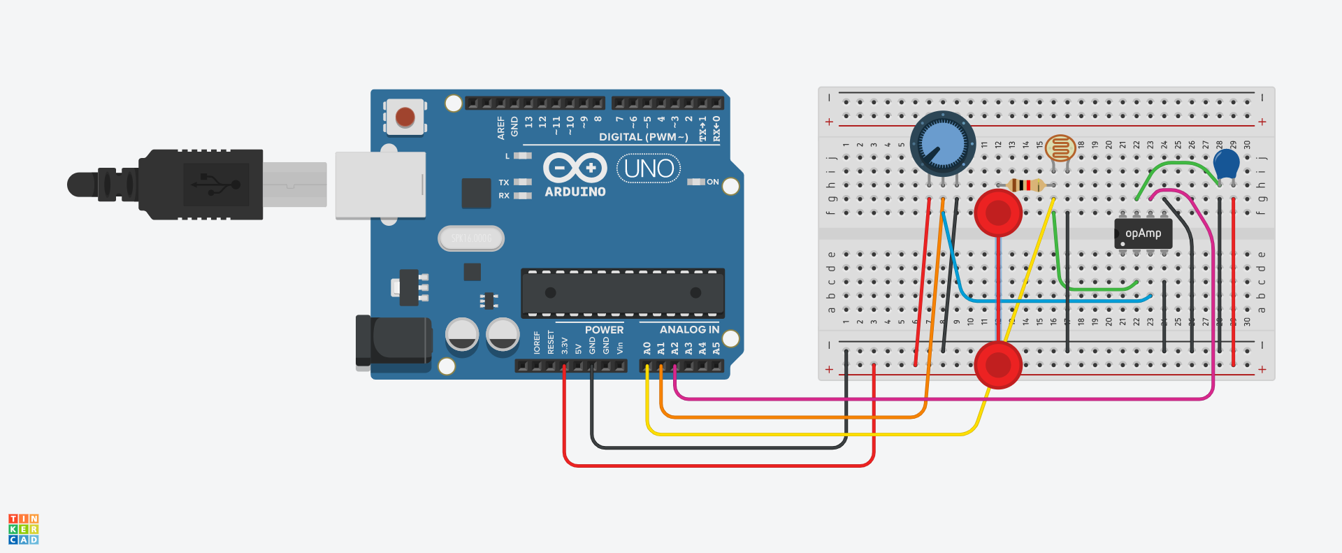

I am working on the Light detector combined with op-amplifier.
Op-AMP is AD623ANZ which has 8 pins.
(Image insert is not working)
Above is the pinout of AD623ANZ.
Below diagram is my full schematic of my circuit.
And the Arduino code I wrote down is as below.

So basically, A0 is Vout from the photoresistor, LDR. A1 is Vout from potentiometer and A2 is Vout from the OP-AMP.
If I connect all the wires and upload the code into Arduino UNO, it perfectly reads all the signals and shows how the light detection varies along with the light condition.

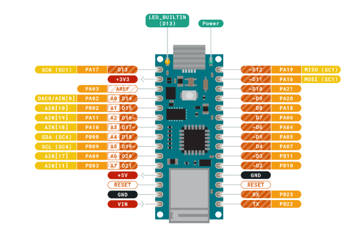

However, if I only change from Arduino UNO to Arduino NANO 33 IoT, all analog inputs are oscillating and reading totally different values from Arduino UNO (I got negative gain).
I just hooked up Supply voltage to 3.3v pin (Second pin from left top) and ground to GND Pin (Second pin from left bottom) of Arduino Nano 33 IoT. And A0, A1, A2 respectively.

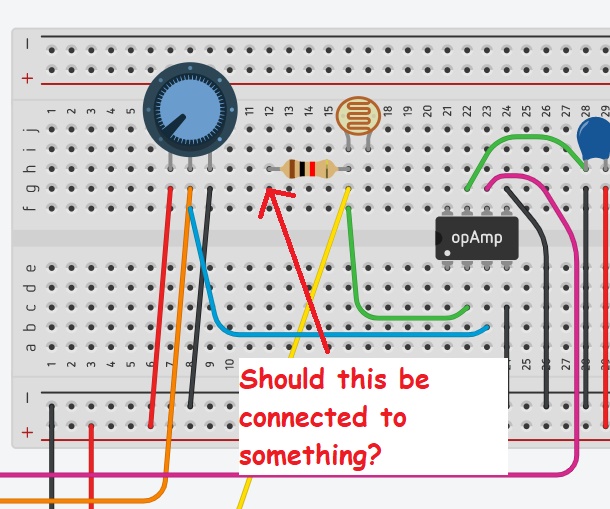

What gain do you expect from the op-amp without any feedback components?
Tom... :slight_smile:

I have uploaded corrected schematic. Yes it should be definitely connected to the GND and Vcc
But still, I cannot insert the attached images. I do not have that icon.

1k pull up for the LDR is for strong sunlight.
You might not need amplification if you use the right value pull up resistor.
What are you measuring.
Seems you didn't power the op-amp (+Vs is grounded),
and you did leave gain at 1x (no resistor, no amplification).
But Fritzing is toddler art, and usually misleading in the hands of a beginner.
Learn to draw real circuit diagrams, with pencil and paper.
Did you look at the input common mode ranges at 3.3volt supply.
The LDR/amplifier might not do what you hope it will do.
Leo..

This is why I hate Pretty (useless) Fritzing pictures.
A hand drawn schematic on the back of an envelope is far superior to any Fritzing picture.
