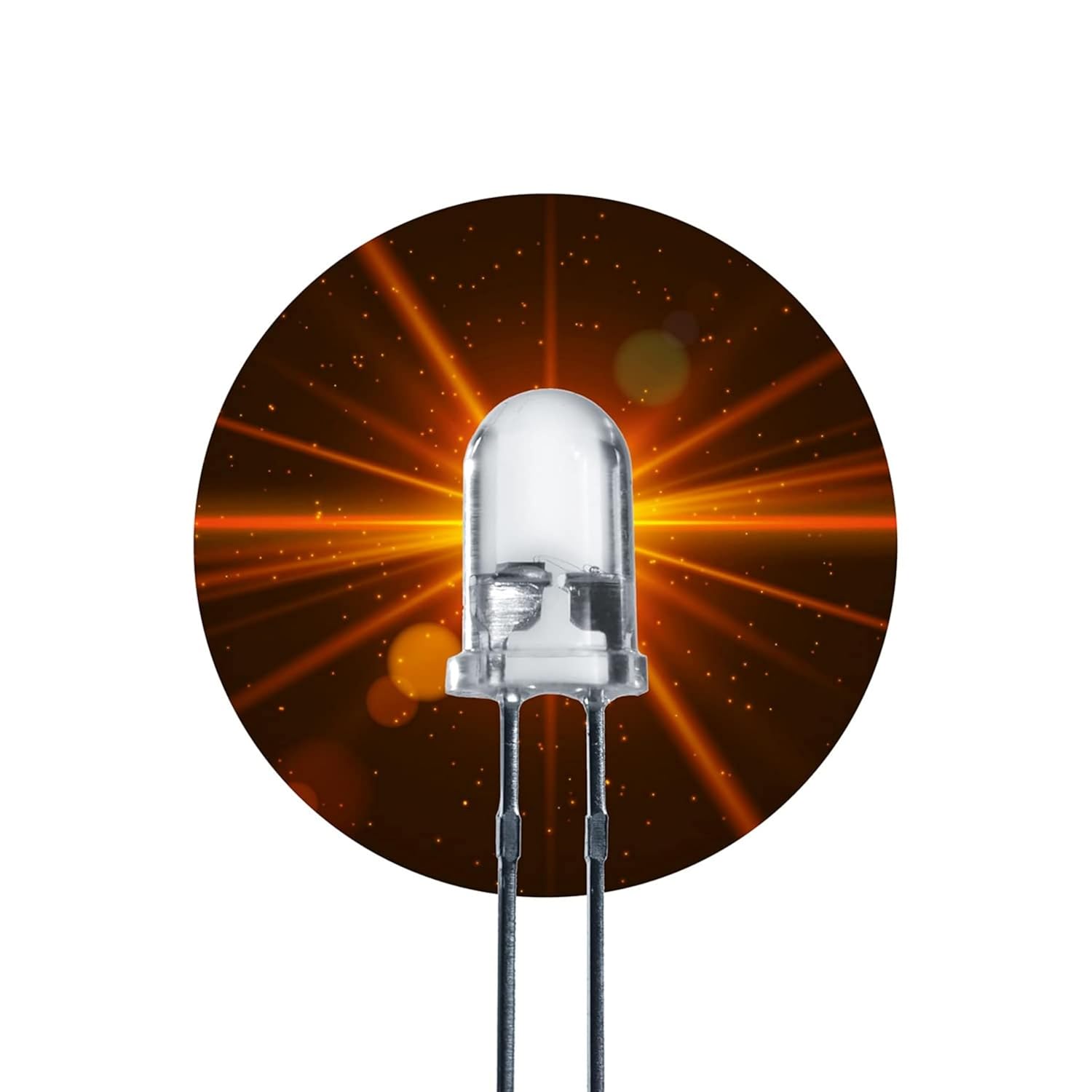

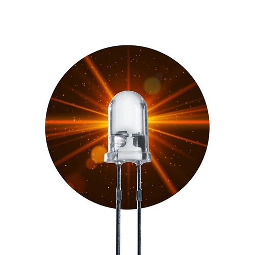

The smds are warm white. All of them.
The Leds on the arduino are 5mm 25000cmd bright white LEDs
b707
April 13, 2025, 8:55am
18
Did you tested them with 5k resistor?
Your LEDs are ranked for 30mA current, with 5k resistor the current will be less than 1mA. I m afraid the LEDs won't lights at all.
In any case, I don't see a point to buy a bright LEDs and then to use it with about of one percent of it's power.

yes they are still bright! Without the 5k resistor they are bright like the sun....
