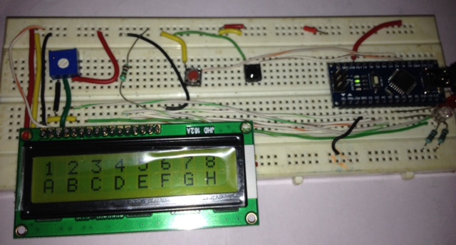

I try to understand LCD display location.
#include <LiquidCrystal.h>
lcd.begin(16, 2);
lcd.setCursor(0, 0);
lcd.print("1");
lcd.setCursor(2, 0);
lcd.print("2");
lcd.setCursor(4, 0);
lcd.print("3");
lcd.setCursor(6, 0);
lcd.print("4");
lcd.setCursor(8, 0);
lcd.print("5");
lcd.setCursor(10, 0);
lcd.print("6");
lcd.setCursor(12, 0);
lcd.print("7");
lcd.setCursor(14, 0);
lcd.print("8");
lcd.setCursor(16, 0);
lcd.setCursor(0, 1);
lcd.print("A");
lcd.setCursor(2, 1);
lcd.print("B");
lcd.setCursor(4, 1);
lcd.print("C");
lcd.setCursor(6, 1);
lcd.print("D");
lcd.setCursor(8, 1);
lcd.print("E");
lcd.setCursor(10, 1);
lcd.print("F");
lcd.setCursor(12, 1);
lcd.print("G");
lcd.setCursor(14, 1);
lcd.print("H");
lcd.setCursor(16, 1);

16X2 ------> 0-15 = 16 locations 0-1 = 2 rows
  lcd.begin(16, 2);
  lcd.print("1");
  lcd.print("2");
  lcd.print("3");
  lcd.print("4");
  lcd.print("5");
  lcd.print("6");
  lcd.print("7");
  lcd.print("8");
  lcd.print("A");
  lcd.print("B");
  lcd.print("C");
  lcd.print("D");
  lcd.print("E");
  lcd.print("F");
  lcd.print("G");
  lcd.print("H");
ok
 Test
0,0 is top left hand side.
15,0 is top right hand side.
0,1 is bottom left hand side.
15,1 is bottom right hand side.

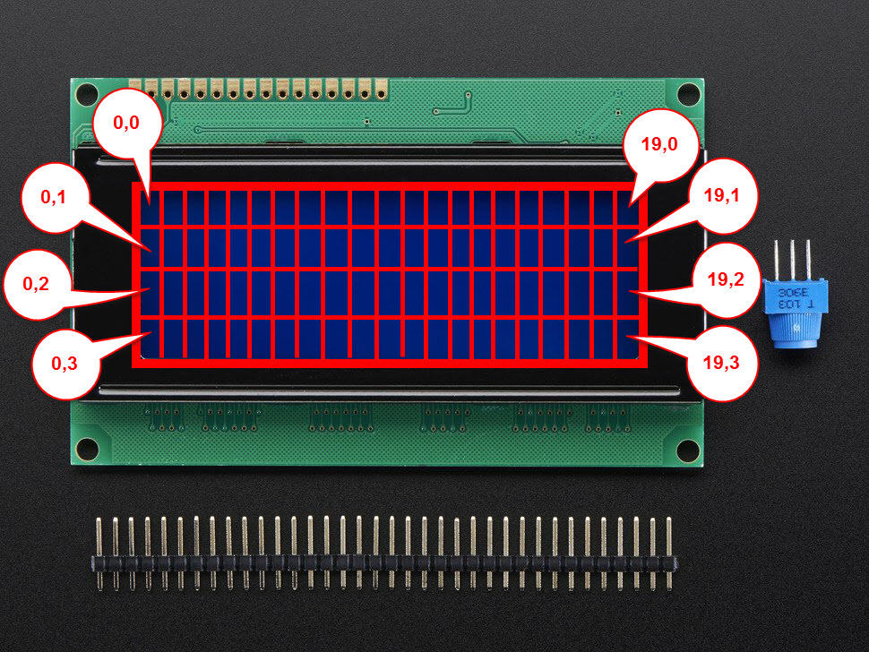

Test question

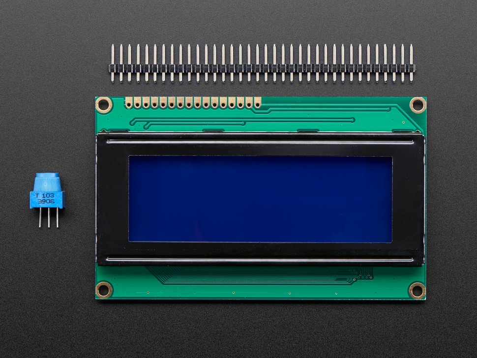

I have a 20X4 LCD.
Where is 19,3 ?
:wink: :grinning:

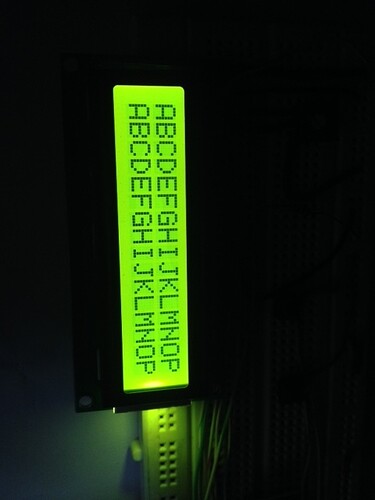

How to Make LCD Scrolling Display?
Try:
//Sketch_01
// Use:  CTRL T    to format your code every now and then
#include <LiquidCrystal.h> //include the LCD library in this Sketch
//initialize the library with the numbers of the interface pins
  //set up the LCD's number of columns and rows:
  lcd.begin(16, 2);
  // Print a message to the LCD.
  lcd.clear(); //clear the LCD screen and go to location 0,0
  //0,0 is the first character on the first line on the LCD
} //  >>>>>>>>>>>>>> E N D  O F  s e t u p ( ) <<<<<<<<<<<<<<<<<
  for(byte y = 0; y < 2; y++)
    for(byte x = 0; x < 16; x++)
      lcd.setCursor(x,y);
      lcd.print(char('A'+ x));
  while(1);
//                      E N D  O F  C O D E
