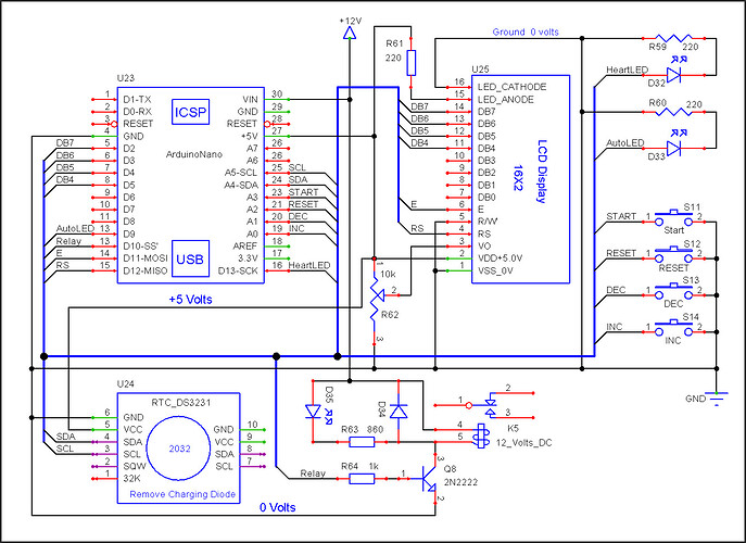

New schematic with the DS3231 RTC:
New sketch that does not need the 3rd party RTC library:

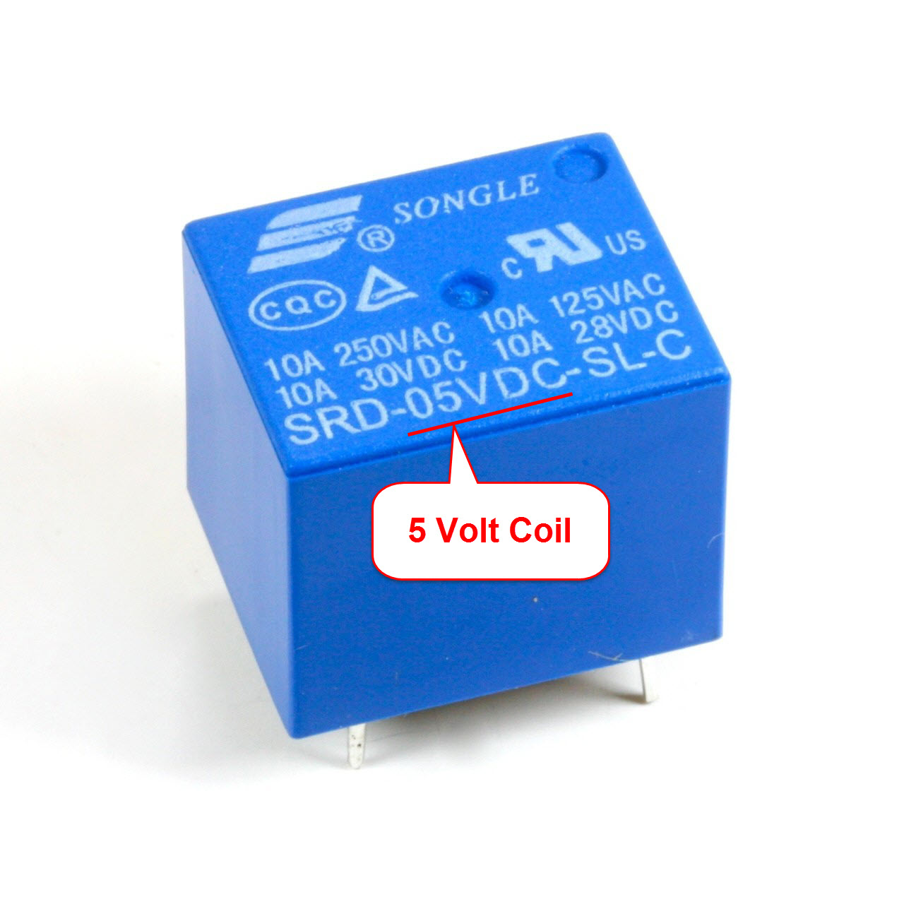

In your post #27
I want to operate one relay (12V)
You said you want to operate a 12 volt relay but the image you showed us has a 5 volt coil.
What relay do you have?

While you wait to get your RTC.
Assumptions
  1. You want to control a device with a relay, example: automatic garden watering.
  2. The relay will be under control of your sketch timing.
  3. Your sketch clock uses a battery backup DS3231 RTC.
  4. You will use the increment and decrement switches to set the relay ON time, example 8:00AM.
  5. You will use the increment and decrement switches to set the relay duration time, example 30 minutes.
  6. If you push the Auto/Manual switch, the ON LED comes on and the OFF LED goes off. In this mode, relay is under control of the timing in the sketch.
  7. If you push the Auto/Manual switch the ON LED goes OFF and the OFF LED comes on. In this mode the relay is no longer controlled by the sketch.
Are the assumptions correct?
What is the function of “Reset” switch?
What is the function of “Start” switch?
What exactly is the relay going to control?

Both relay, i have 5V and 12V, i use 12V relay.
  • Yes
  1. The relay will be under control of your sketch timing.
  • Yes ( in auto mode)
  1. Your sketch clock uses a battery backup DS3231 RTC.
  • Yes
  1. You will use the increment and decrement switches to set the relay ON time, example 8:00AM.
  • Yes
  1. You will use the increment and decrement switches to set the relay duration time, example 30 minutes.
  • No
*** I will use the increment and decrement switches to set the relay OFF time, example 5:00PM.
  1. If you push the Auto/Manual switch, the ON LED comes on and the OFF LED goes off. In this mode, relay is under control of the timing in the sketch.
  • some modification here, required one LED only.
** When i press auto/manual switch, LED shown timer in auto or manual mode, (If, led ON means timer in auto mode and LED OFF means timer in manual mode)
*** In auto mode timer will work as per set ON-OFF timing and in manual mode timer will ON relay directly.
  1. If you push the Auto/Manual switch the ON LED goes OFF and the OFF LED comes on. In this mode the relay is no longer controlled by the sketch.
-NA
What is the function of "Reset" switch?
  • For set time
    What is the function of "Start" switch?
  • For set time
  • Relay working depend on ON-OFF time, when set ON time match with clock time relay will ON, and when set OFF time will match with clock time relay will OFF.
    If the power fails, what mode is the clock to be in when the power comes back on?
  • Power fail condition relay will OFF and when power comes back, timer will checked the ON-OFF timing, If OFF time not passed then relay will ON, and if OFF time passed relay will OFF.
So the LED can be called the: AutoLED
When the LED is turned on you are in: Automatic.
When the LED is turned off you are in: Manual
  • For set time
    Set the time the relay turns off.
  • For set time
    Set the time the relay turns on.
    What kind of device will the relay be connected to?
Edit:
NEW SCHEMATIC
CounterValue = CounterValue + 10;
CounterValue = CounterValue - 10;
ok, i try both are working ...
So the LED can be called the: Auto LED
  • Yes
  • For set time
  • Yes
  • For set time
  • Yes
  • Automatic Valve (Water)
