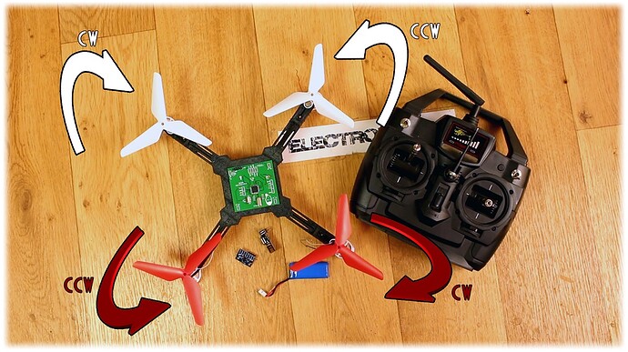

It is hard to tell from your video, have you checked the direction of rotation of the motors, as per the image from the instructions.
And you do have the correct props on the correct motors?
Do you have a DMM to prove that the suspect motor is being supplied less power?
I also notice you have three motors with black and red wires and one with blue and red, is the blue and red wired motor the suspected unit?
I'm not sure but there appears to be an anomaly
Even though in the Electronoobs video he has them configured direction wise as described in the image.

Edit: the OP's propeller picture looks correct. See the orientation of the legend on the props. Doesn't mean they are spinning in the right direction, doesn't mean the flight control software wants the standard motor directions, could be exactly the opposite.

The colour of the wires distinguishes the pairs and as @Paul_KD7HB and @alto777 confirm the are motors that only perform properly if driven in the correct direction.
You should have 2x CW and 2x CCW motors.
This picture shows you have 3 of one direction and 1 of the other direction.
That is 3 black and red wired motors and one blue and red wired motor.
Tom... :slight_smile:
The motors I got from amazon has all same motor wire color ( red and blue). Same goes for the Ali express motor except the color of all motor wire is red and black . is there any way to know if they are CW or CWW.
