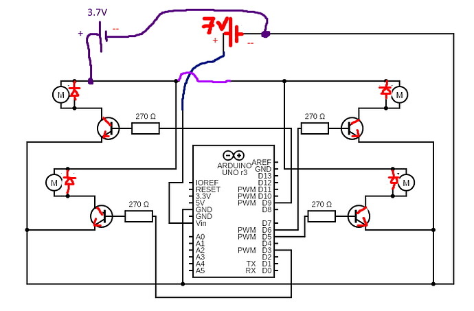

Four DD motors all spinning at different speeds.
Hi all! This is my first forum post, so I apologize for any lack of decorum my post has. Feel free to correct any errors you see .(actual problem statement is below my code, if you want to skip the background) I have done some work with Arduino before, and made some basic inventions (like a machine that stirs your coffee), but I do not have a ton of experience with circuitry, and have never been formally trained. I am trying to make a quadcopter using normal DC motors, not the ridiculously overpriced ones on Amazon, and I have tried many different approaches with motor drivers, but they are usually too heavy or need too much power or something else. I decided to make my own drivers with this tutorial:
I used 2N2222 NPN transistors, 270 ohm resistors, a 3.7v lipo battery, and 1N4001 flyback diodes. The motors I got are here: https://www.amazon.com/USAQ-Coreless-Brushed-8-5x20mm-Propeller/dp/B06Y11C2HL/ref=sr_1_6?dchild=1&keywords=4+small+dc+motor+with+propeller&qid=1609860121&sr=8-6
I have attached a png file of my circuit diagram, and my code is below:

Hello and welcome.
++Karma; // For posting your code correctly and including a schematic on your first post.
Now please revise your schematic:
The transistors, diodes and battery are the wrong way round.
  • Diode cathode to positive
  • Transistor emitter to 0V
  • Battery long side is positive
I'm unsure about this and happy to be corrected
but I dont think you should be repeating your analogwrites so quickly,
so could you try adding delay(1000); to your code?
Then try commenting out all but one channel at a time to see if each runs correctly on its own?
I'm not convinced that Uno is doing anything with only 3.7V connected to Vin (which needs a minimum of 7V).
Also your motor specification is lying to you. There is no way on earth that those motors can turn 65mm props at over 50,000rpm and take only 100mA. Even 10 times that current is probably too low.

I agree with slipstick about the questionable specs for the motor.
Anyway ------ OP ----- this amended diagram can help with at least getting the motors to turn. Let me know if I slipped up anywhere in doing the mods.
"Operating Current: 0.08A-0.1A" :o
I even doubt if 'free-running' is that low.
With a prop it's much higher.
Expect a stall current of 5-8A
A 2N2222 is just silly. You will need mosfets with low Rds(on)@5volt.
Leo..
True ---- I agree with wawa.
Go for transistors like FQP30N06L, a N-channel logic-level mosfet. Or FDP65N06.

Thank you all for responding so soon. I am amazed at how prompt and helpful this wonderful community is! I will try to answer some of the questions you all have asked me, and I really appreciate your contributions.
I have switched the slow moving motors with the fast moving motors, and the problem is not with the motors. I have connected the motors independently to the same power source, and they span at the same speed. "DD motors" do not exist to my knowledge, that was a typo on my part :). I have attempted larger power sources, and I have powered the arduino separately, with the same problems. I made the schematic right before posting the question, so there might be errors. I have yet to get the drone in the air, so I cannot measure flight time (zero minutes, if you want a specific number). I will continue to update as more responses (hopefully) come in, and tell me if I missed a question. Now I have a few questions to ask in return:
If I used the MOFSETS recommended by various users, would my schematic change, or would it just be a change in transistors (I can find the difference in base, collector, and emitter pins, as it I imagine it varies with the specific MOFSET. Also, why are 2N2222s deficient? I checked their specs and made sure to purchase motors that would not strain them. Also, the tutorial I linked above used the PN2222, which is very similar to the 2n2222, and made no mention of overstraining them (This is not criticism, I am genuinely curious). I was also unaware of the difference in frequencies of the PWM pins, which could certainly be the case. I will post more answers to questions and updates after I try this. Thanks once again to the kind souls who took the time to help someone in need.
Also, here is a revised diagram thanks to Perry. Sorry for the amateur mistakes :).

Thanks for the update and the much improved schematic. If you use MOSFETs the connections are called drain, source and gate. For an N Channel MOSFET, which is what you need, they correspond to
Emitter > Source
Base > Gate
Collector > Drain
MOSFETs are better because they have very low on resistance and draw virtually no current into their gate connection.

While not denying the benefit of using the right MOSFETS, if the motors are spinning quickly I would read that as confirmation the circuit is working using 2n2222
@John,
I think you will have to agree that the On resistance of a 2N2222 is counter-productive.
