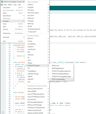

I'm trying to get the WiFi on the Opta to work.
I'm doing the tutorial on this link: https://docs.arduino.cc/tutorials/opta/getting-started-connectivity

The opta responds with this message:
Attempting to connect to SSID: my network
File not found
Please run the "WiFiFirmwareUpdater" sketch once to install the WiFi firmware.
Where do i find the WiFiFirmwareUpdater sketch?
I figured out how to update the firmware using the WiFiFirmwareUpdater sketch from another post by Koppit.
File-> examples->STM32H747_System
