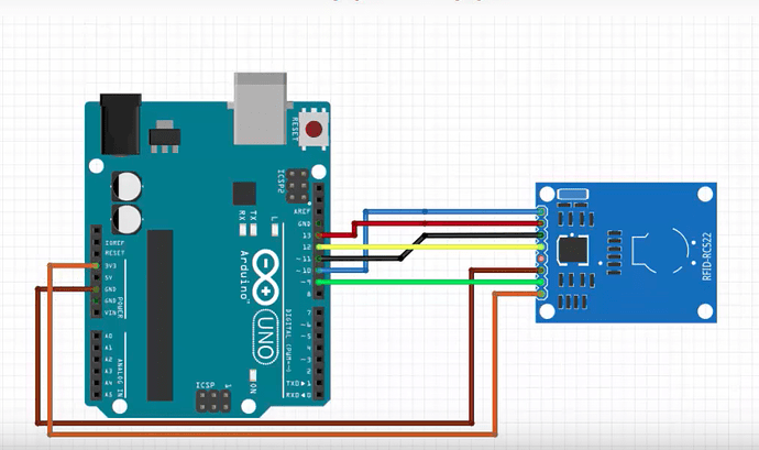

Hey there,
I've been stuck on this situation for quite a while and any help is appreciated. I'm trying to connect my Arduino Uno to the RFID reader RC522. When I go to my serial monitor i am given the prompt below and am unable to view the RFID card UID using Dumpinfo:
Firmware Version: 0x0 = (unknown)
WARNING: Communication failure, is the MFRC522 properly connected?
I have checked my pin layout and it looks like this:
MFRC522 UNO
RST 9
SDA(SS) 10
MOSI 11
MISO 12
SCK 13

Sorry! Power is at the 3.3v pin and GND is connected to both.
Here is a better reference.

steve1234:
And you are quite happy connecting 5V signals to a 3V3 board?
spycatcher2k:
Can you post a link to where you bought the module please.
https://www.creatroninc.com/product/mfrc522-rfid-nfc-starter-kit-1356mhz/
Grumpy_Mike:
I'm connecting it to 3.3v on the uno ...? Sorry, I'm still in the learning process.
(deleted)
spycatcher2k:
Did you connect pins 10 - 13 directly? or through a level converter?
If directly, then you MAY have blown your chip.
I figured out my problem. I resoldered the pin headers and it worked! Thanks for your help anyway.
steve1234:
But the signals out of the Uno are 5V. So you have a device powered by 3V3 being fed several signals of 5V! Putting signals into a chip that exceed that chip's power supply by 0.5V is a great way to destroy a chip.
No you didn't.
