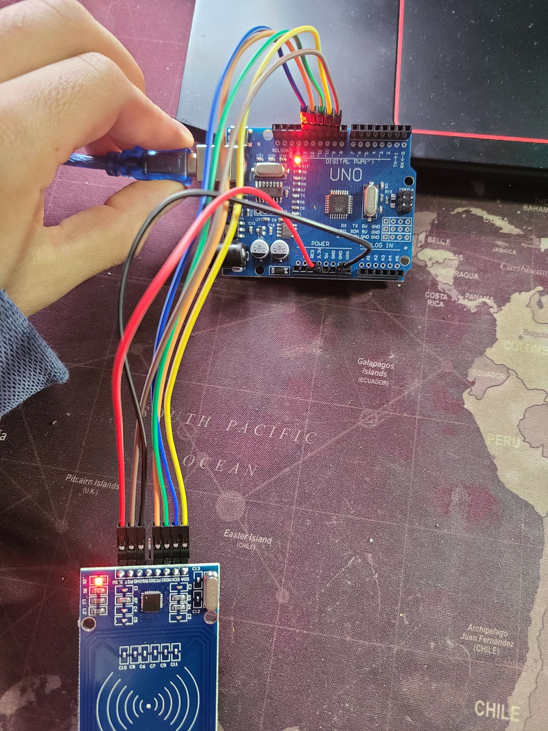

Hi, this is my first post, and I'm having a problem connecting the Arduino to the RC522. I used the MFRC522 library from GithubCommunity. I was trying to use the DumpInfo example:

It gave me the following error (This is from the FirmwareCheck but is the same):
***************************** MFRC522 Digital self test ***************************** Firmware Version: 0xFF = (unknown) WARNING: Communication failure, is the MFRC522 properly connected? ----------------------------- Only known versions supported ----------------------------- Performing test... ----------------------------- Result: DEFECT or UNKNOWN
This is the circuit:
If someone could help me or correct something I've done, I would really appreciate it. I'm just learning how to use Arduino and I'd like to master it properly.
Thank you for using code tags. However the photo is useless. Make a hand drawn wiring diagram of YOUR setup and take a readable labelled photo.
Also, make sure ALL the serial log is posted also in code tags.
I based the circuit on this image:
And I don't know what do you mean by your last response. Sorry, I'm still trying to figure out how to post correctly here :3
Please present as schematics.
Those RFID modules use a MFRC522 controller, which is a 3.3V device. It is not 5V tolerant. Your Uno is a 5V device and hence outputs 5V level signals. You need to do level shifting on all the output signal levels. Something like this:
Oh thank you. I thought that using the 3.3V pin would make it work :3
You can also use resistors for this level shifting like this:-
Almost all the internet gets this circuit wrong. Without level shifting you will damage your Arduino pin or the RFID reader. Yet the idiots out there keep on perpetuating this myth that it is fine not to use any level shifting.
You might want to look at this How to get the best out of this forum before you proceed any further.
It will tell you how to post code on this forum.
The serial log is simply what is printed out on the serial monitor, when you run your code. Post this as if it were code, not as a picture.
