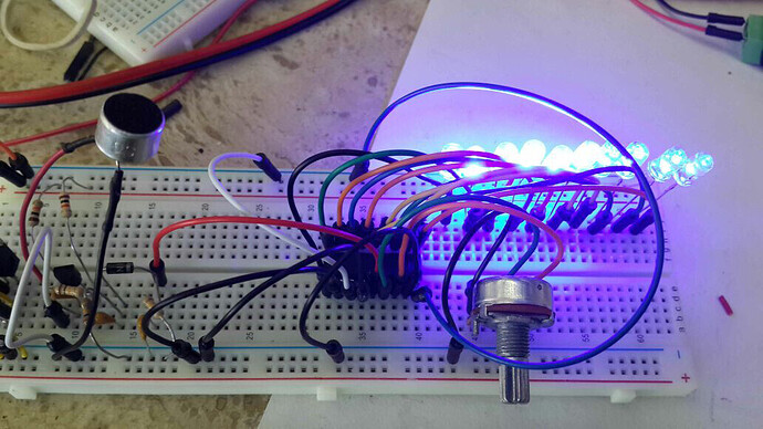

It is possible to do it with the LM3915. Matter of fact yesterday I finished my fisrt circuit basd on that IC
Here I attach the schematic I replicated made by Gaston of Proyectos Led (Youtube channel).
The controller will be a chineese rgb IR controller the ones you get on ebay for a couple of dollars.
I want to do exacly this:
Vu Meter With RGB Led Strips
Somehow this guy manage to do what I wanted to do but right now I'm kind of lost n the connection adn type of transistors to use.
BJT? Mosfet? N or P channel? Resistors at the base of each output of the IC pins where the led strip is going to be?
The post is in german and although I translated it with google translation, my knowledge of electronics is basic I'm learning :slight_smile: so I do not understand fully what is says there.
RGB Vu Meter with led strips
I hope is more clear now.
After I do this with the IC I will step in with arduino I guess. One step at a time.
Thanks again
Belen
Here I attach the VU Meter working with the LM3915 IC

I think you are misunderstanding.
The LM3915 will generate a bar display but it is not a VU display the relationship between the input volume and the display strip will be logarithmic not in Volume Units. Yes it will bounce up and down with the volume of the signal but they will not be in Volume Units without using the LM3916 chip.
Look at the circuit on page 5 of the LM3916 and compare it with the circuit on page 7 of the LM3915 data sheet. You will see that the resistor chain has different values so giving you a different relationship between the input voltage and the LED lit.
The German web site is telling you what I said in reply #2. Replace the LED with a pull up resistor. Then the output is a signal that will be 0V or 5V. With this you can use a transistor to switch a much heaver load than a single LED.
You can use any of these.
Basically use a P channel FET or a PNP transistor for driving a 5V load, or an N channel FET or NPN transistor for driving a higher voltage load. It all depends on what sort of strip you have. They are normally either 5V or 12V working with built in current limiting circuits. This shows you how to use a 12V strip using NPN transistors or N channel FETs. Usage | RGB LED Strips | Adafruit Learning System
In place of the Arduino, just connect it to the output of the LM3915 chip with the pull up resistors fitted as mentioned above.
