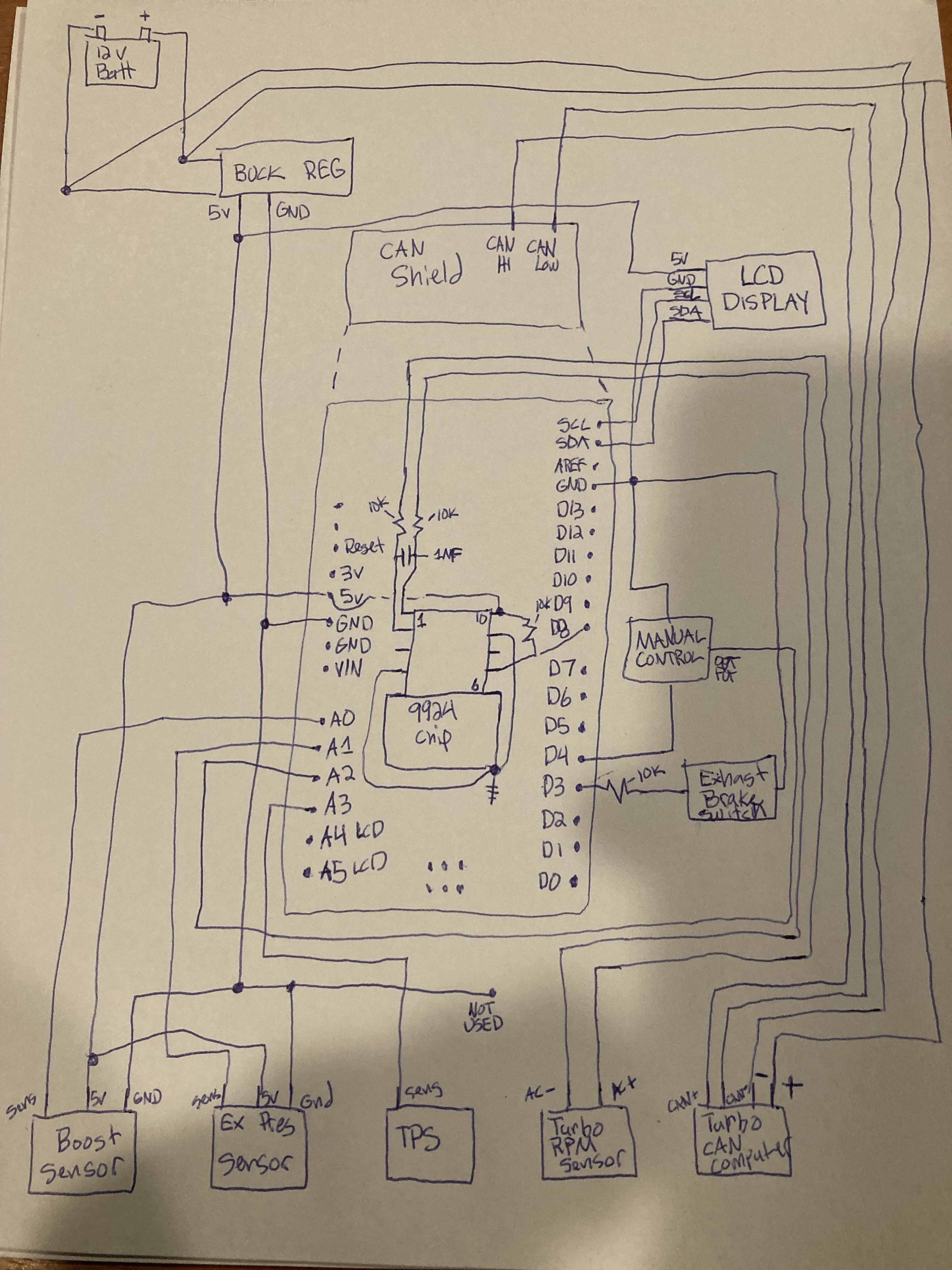

I use an Arduino uno to operate a servo motor, which adjusts vane position on a Variable Geometry turbo in my truck.
It works great, except for one issue: when I attach my snow plow to my truck (electric over hydraulic plow), it draws a lot of current. So much current that it pulls my battery voltage down, and my Arduino stops working. When this happens I basically have no control over my turbo, and the only way to get it to work again, is to turn off my truck, and restart it.
My current set up takes 12v power, and runs it through a buck resistor to make 5v for my Arduino. I think I should add a capacitor and diode to keep the arduino alive and prevent the plow from pulling voltage from my Arduino.
Is this a logical thing to do?
If yes, how would any of you do it? Capacitor and diode on the 12v feed, or after the buck resistor on the 5v feed?

I use a 120503 15w buck regulator that changes 12v to 5v.
Sorry about the delay in response. It took me a little while to find my wiring diagram.
Here’s the current set up. I was thinking of putting in a capacitor and diode in before or after the buck regulator.
The first thing I’d recommend is replacing the buck converter with a SEPIC converter. What you’re experiencing isn’t unexpected, as the 12V system in vehicles can be very harsh. Looking at your schematic, it doesn’t seem robust enough for a vehicle environment. For starters, you're missing termination resistors and transient protection.

That buck is rated for 8-22V input voltage. You could replace it with low dropout buck. There are some that can supply 5V 3A with 5.3V input voltage.

I was thinking a diode and capacitor before the buck regulator would solve my problem, however; (as many have pointed out) the issue is most likely my buck regulator. You had suggested a SEPIC regulator. I looked up SEPIC regulators and am so confused as to which one to buy. I read through a bunch of tech sheets and cannot decide which one would be best to step 12v down to 5.
Does anyone have a recommendation on which one would work best for me?
