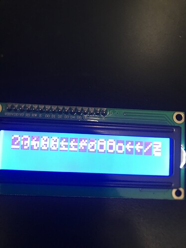

Hello, I am making an alarm clock for my school project. I have completed my coding and there are no errors showing up. I also believe that my breadboard is put together correctly. However, when I first plug in my display, a zero pops up. When I hit the buttons I have set up, a random series of unknown characters pop up.

Have you tried running the simple example sketch that comes with the display library, to confirm that your display hardware and library is working?
you might miss an lcd.begin()of some sort depending on your library
Yes. Before I set up my breadboard for my alarm clock, I used my display and ran the hello world code. It ran smoothly.
did you have lcd.begin() in the code that worked?
No, when I put that, it says "no matching function for call to 'LiquidCrystal_l2C::begin()'
It might be 'lcd.init()'.
or their might be some parameters. What's the link to your library? or can you look at the setup() of you working code for any initialisation call?
it is done, thank you :slight_smile:
What is done? :slight_smile:
Words are popping up on display. It was the 'lcd.init()'
