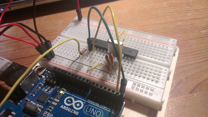

I'm trying to get a sketch on a seperate Atmega328P-PU with arduinoISP. I have the chip lying around for a while and could swear I've burned the bootloader to it before. However, using this tutorial yields:
avrdude: stk500_getsync(): not in sync: resp=0x00
Trying to burn the bootloader again using this tutorial yields:
avrdude: Yikes! Invalid device signature.
Double check connections and try again, or use -F to override
this check.
I've tried checking each connection so many times, pictures of both setups are attached. The pins on both Atmega's are wearing down from the constant connecting and disconnecting, so I hope to figure this out soon!
That is a '328P, not '328?

And that's a 16 MHz xtal? Not the typical package we see. Sure looks like data rate problem.
I was suprised at getting such a large package too. But it's what I got at the shop and it does say 16.000Mhz on the side, so..
In the BIG packages, there is a possibility that the normal crystal load capacitance requirement is different than the more traditional packages. In fact, you may not even require the capacitors.
If possible, backtrack to the vendor you purchased from and try and track down a datasheet. Otherwise, try without caps, then with 6pF, then with 10pF, etc. If you get to 30 pF and it is still not function correctly... probably is not the caps! :astonished:
Edit... looking over some PDF from Farnell, physically larger crystals seem to require larger load capacitors... at least in the example I studied. Any xtal freaks out there that can add info here?

I gather you guys blame the crystal. I've ordered new crystals online, since I don't have any other capacitors lying around (aside from 10 µF, but I don't guess those'd work). I'll keep you updated, but any further ideas are welcome.

I got my USBasp today, and using that I get
"avrdude: error: programm enable: target doesn't answer. 1"
So to me this sounds less like a timing issue and more like a chip that does nothing at all. Is this possible and if yes, how do I check it/fix it.

Got it fixed in the end. Just don't ask me how I did it, because as far as I know it was the same thing I've been doing for days :stuck_out_tongue:
