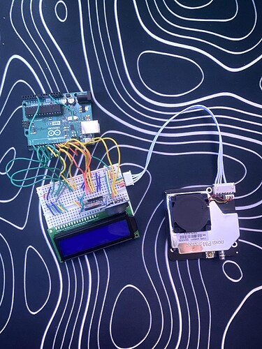

If you don't illustrate your wiring, I'm not able to help. I mean real wiring, that photo is from your tutorial.
The real wiring is hard to understand because I've done it on a small breadboard. Nevertheless, the photo has been attached.''
Difficult to see...
Where is GND?
also how is sdcard wired to arduino, pin to pin.
Did any steps you took involve getting just one of the external parts you are connecting to function correctly?
You have the LCD, the SD and an RTC, at least. Did you write or find a sketch for each of those that woukd let you test it, and your wiring, independently?
How many times do you have to rewire something to be certain the wiring is correct?

The angle of the photo makes it hard to follow the pin alignment.
If the VO pin is connected to the 2nd blue wire ,that wire does not go anywhere.

As I said before, it would be difficult to see because I'm using a small breadboard and it's all a mess.
The SD card wired to Arduino, pin to pin is a little different from the diagram (in the sense that DI/DO are replaced with MISO/MOSI), but should theoretically work (according to some sources online):
