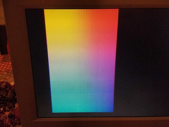

Arduino UNO/NANO - DMX VGA Analyser in 17bit Colour (RGB656 format)
I am currently working on another Video project
VGA 640x480 mode @ 60hz (thanks to Smaffer and Nick Gammon for inspiration)
Using a UNO (or NANO) at standard 16mhz speed
probably looking at 200 pixels across and whatever looks good vertically
I have worked out 3 font sizes to get up to 33 chars per line (not using SPI bit bashing)
and I am pretty sure I can get 131,072 colours on screen at once
I have worked out my timings and there is a small amount written in C, but most is written in ASM as it about my only option for speed
The intention ultimately is to have a VGA display of DMX512 data (250kbps) as a magnificent bar-chart
Its crazy what you can get out of an AVR !!
Bob
Its a good start - I am using different axes to cross-fade colours
Although... does anyone have a clue why I cant get my picture to stick to the left hand side of the screen ?
Its as if I am in the wrong VGA mode or something, but I cant see how

I have done some maths and I think I can up this to 800*600/60Hz SVGA Mode (obviously NOT get that resolution).
It will be a bit more blocky than the video, but I would like to fill the screen without having to use the controls to stretch it into place.
I know others have had the same issue, but i think going for the higher mode will achieve this
