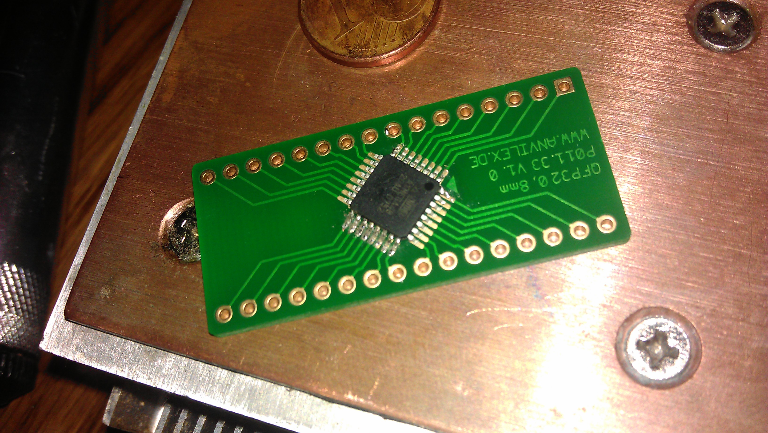

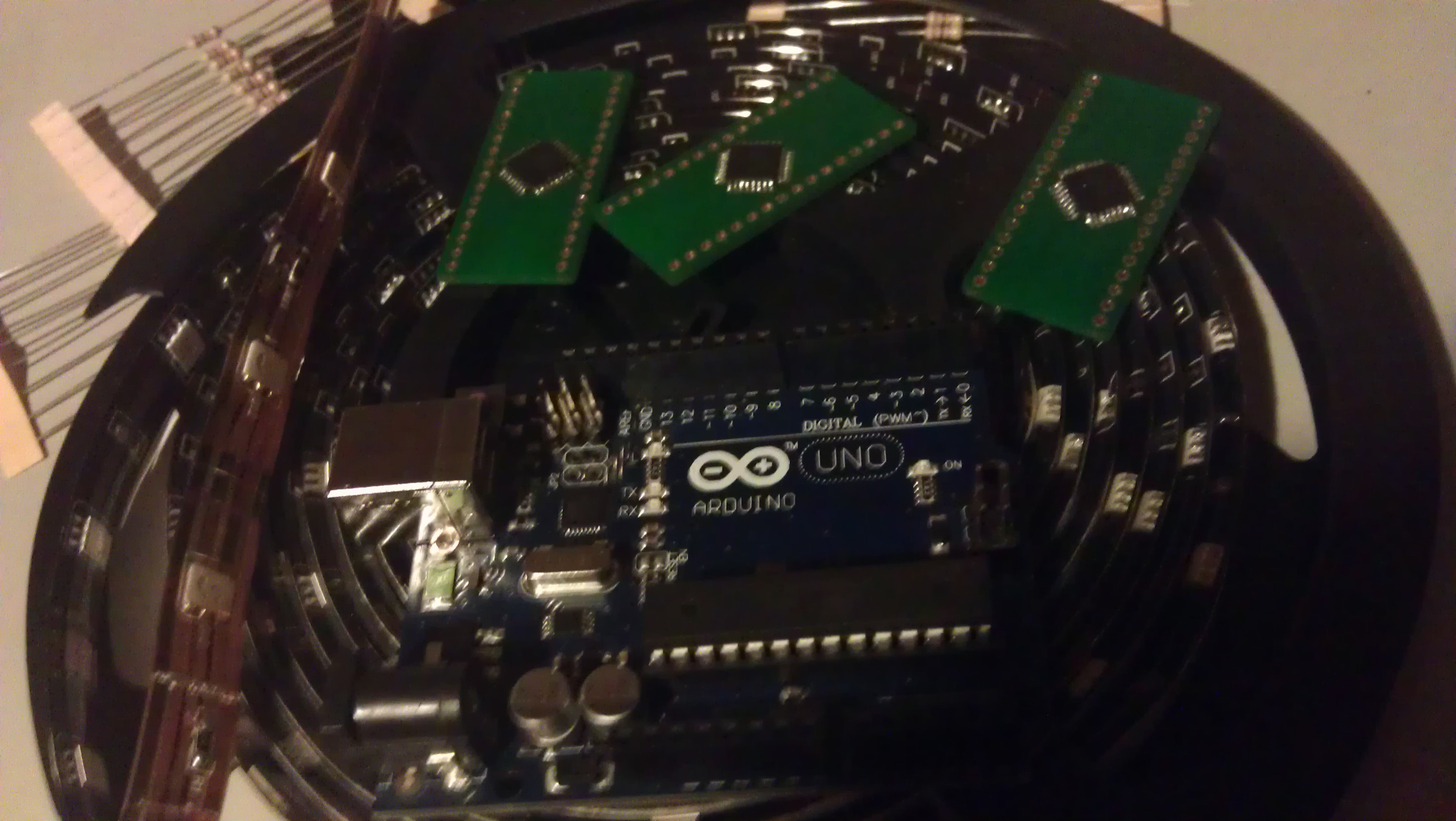

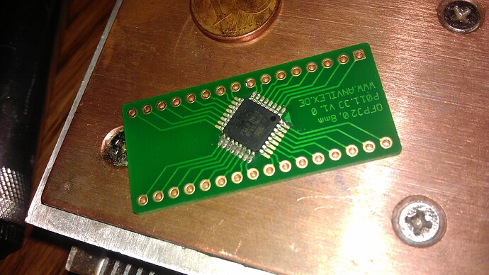

I have 3 ATmega48-20AU and an Arduino UNO.
Now i wanna controll the ATmega48-20AU with my Arduino, with the Wire include.
Upload a little script on the ATmega48-20AU and controll it then...
sorry for my bad english i'm a german ![]()
