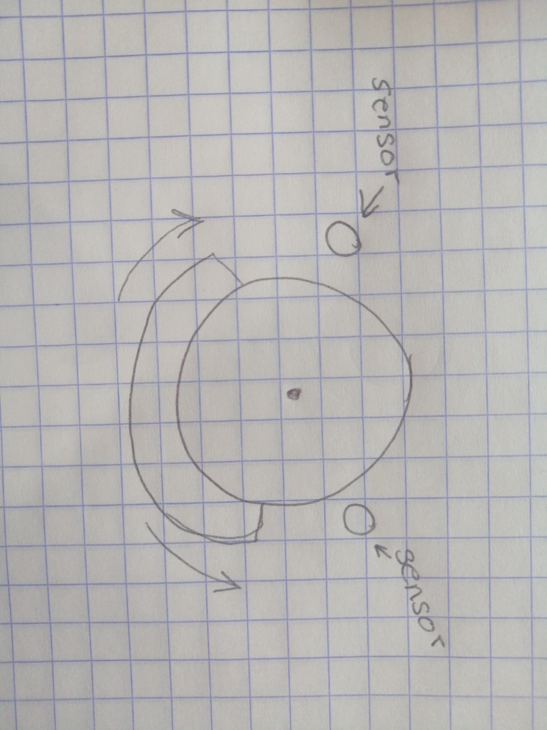

Hello i want to steer with encoder + stepper motor so how can i add a limit but be able to turn back

Okay I want to use arduino one + Dm860I driver with nema 34 stepper motor and 2 stop switches ant each end. then use a analog encoder to steer the stepper motor

I just want the motor to stop so it won't over turn
For that, no Arduino is required and for safety reasons, should not be involved.
To protect from overrun, have the limit switch cut off power or step pulses to the motor.

OK, good. Then finally back to you original question about how to add a limit switch. That answer ALL depends on the physical layout and construction of your device. You need to include something to actually turn your switch on or off as you steer. What do you have in mind to make that work?
Is it sort of like Stepper.h's knob example or AccelStepper's Proportional control, but with an encoder instead of a pot and some limit switches like MobaTools's Stepper Reference Example?
200A at 24V is a dangerous amount of power. Definitely use some limit switches to cut the power electrically for safety, and maybe use a separate switch or two for homing/machine control.
I have in mind a sensor
Something like this
ih
Looks like a reasonable start. Please continue!
