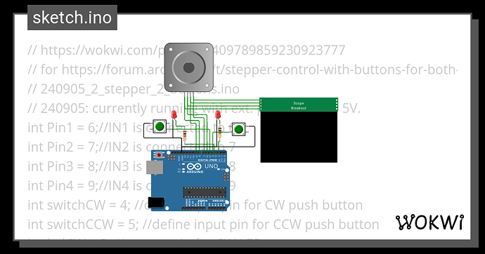

Hello,
I am now running the below sketch for my stepper motors to run back and forth. One switch to move CW, the other to move CCW. I want to limit the movement of the stepper now to 90° by a push of the switch. I have problems to identify where to add a loop and which one best. Can anybody help me modify below sketch ? Many thanks.

What do you mean by this:
It sounds like you want something more complicated than just acting on the level of a variable. Maybe this would help:
https://docs.arduino.cc/built-in-examples/digital/StateChangeDetection/
As would these:
... for separarating the reading of the switch and planning the motion from executing the motion so you can do both things at the same time.
You will need to know your stepper motor "steps per revolution" and divide by 4. For example; if your stepper has 200 steps per revolution, that is equivalent to 360 degrees. To make your motor move 90 degrees, which is 360 divided by 4, you would move your motor 200/4 = 50 steps.
I would guess that you mean that each press of a button increases/decreases the target position by +/-90°.
In that case I would use a couple state variables to remember the target and position of the stepper, (I'd declare them with long target = 0 , position=0;) and then use the stateChange/edgeDetection on the button presses to increment or decrement the target to plan the motion. Then separately I'd compare the position to the target to set dirStatus. Then I'd use dirStatus to set the LEDs and make the steps, and when I made the steps, I'd update position accordingly.
At any time during the run, the state variables target and position would be enough completely describe what the system needs to be doing.
If you are still there, that's how I would approach it.

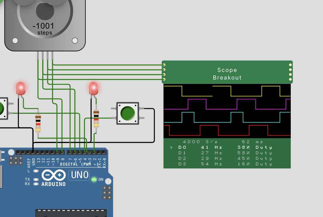

Because this phase-table does half-steps, it needs twice the indexing as a full-step configuration.
Also, since the coils are updated from the table after the index is changed but before the limits are enforced, there is an all-off in the one direction when poleStep==8, and some undefined behavior when poleStep==-1 in the other direction.
