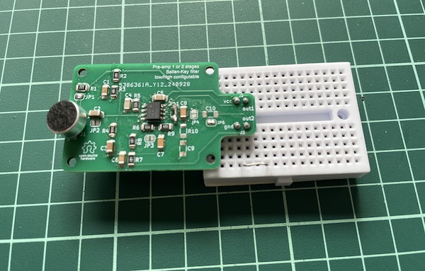

I do some projects with bats ultrasounds. For testing, I have created a small PCB just to amplify, where I can feed the input signal very close to the opamps. In this case a mic, but could be anything.
In the final design the input is even closer to the opamps.
This PCB can be setup with any SOIC-8 opamp as: one ampl stage + buffer, 2 ampl stages, or 1 ampl stage + 2nd order filter.
And you should power it for example with a small AAA battery in a holder with 2 jumpers.
This is still just for testing. At the output you have a strong signal without noise (almost), that you can send to the MCU or ADC with short wires. But the noise will be not critical there, with a 2V or 3V signal. At least for testing.

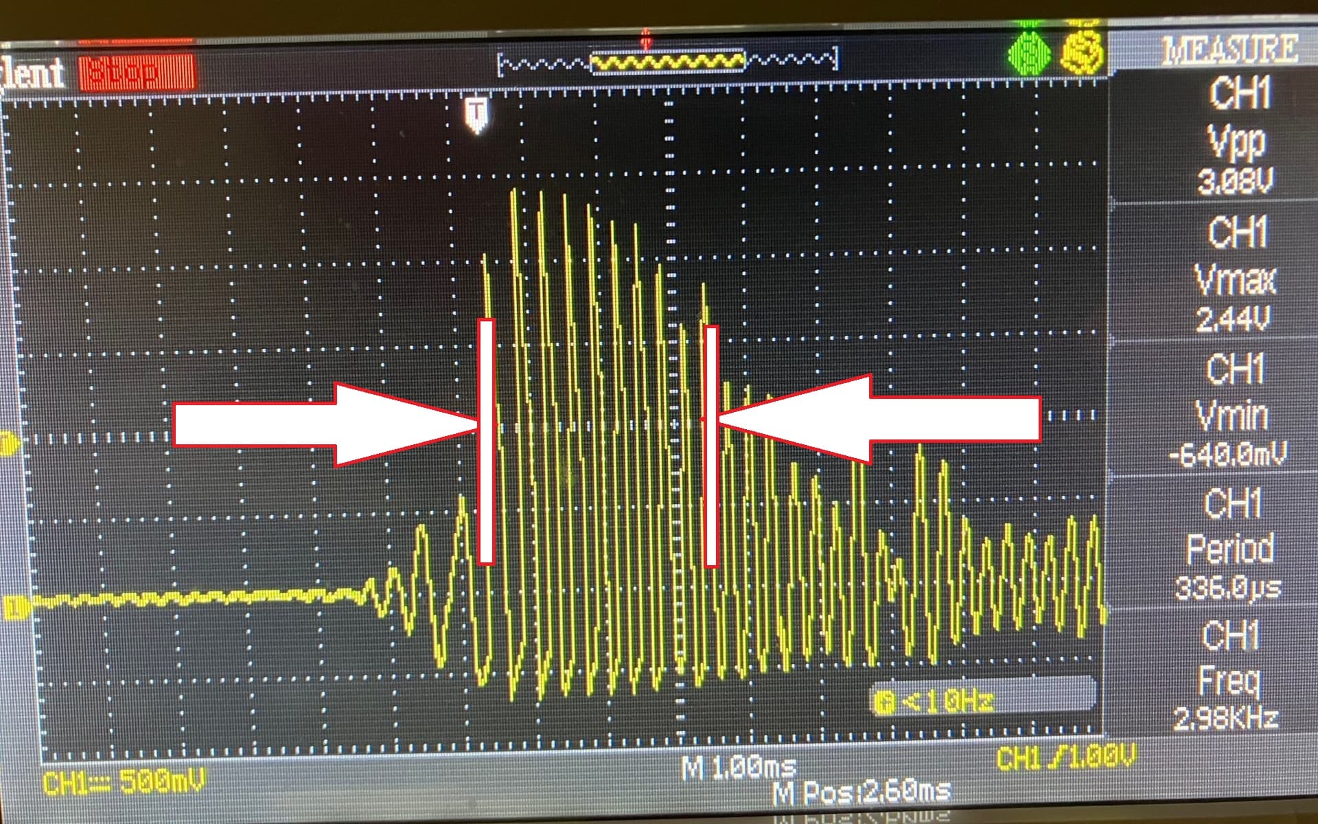

This is what a typical signal will look like. For my purposes, it will always be between 1 Khz and 25 Khz and the frequency never exceeds the 1ms period length. But the entire signal is about 6-8ms in length (so the sampling envelope should be minimum that long, or continuously sampled. And from that array the FFT must grab that dominant peak area at the beginning. And sampling needs to be accurate down to 40us with about 1% accuracy.
What's ironic is that my oscope gets it correct every time. I wish I could just transplant the algo from it into a smaller footprint :slight_smile:

Not according to your scope picture.
