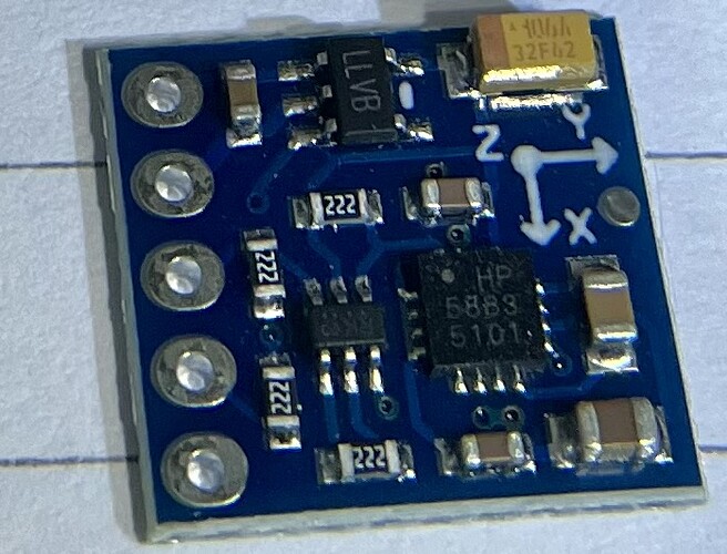

I have been purchasing the GY-270 magnetometer board for years now, orginally the chip was a HMC5883L (address 0x1e) which became obsolete and then becoming a QMC5883L (address 0x0D) IC id: HA5883 which worked fine for our purposes but now those chips have now become a HP 5883 IC at address 0x2C. Unfortunately thats where it ends, the I2C detects it at that address and when I look at the data at that address it is as follows: Found address: 44 (0x2C) Reading from address 0x2C: 0x0: 128 0x1: 0 0x2: 0 0x3: 0 0x4: 0 0x5: 0 0x6: 0 0x7: 0 0x8: 0 0x9: 24 0xA: 0 0xB: 0 0xC: 0 0xD: 0 0xE: 96 0xF: 0 Which is nothing like the old chips. Holding a magnet near the chip does absolutely nothing and no values change. X -128 Y - 0 Z - 0. Is every single board now a fake or do we have to create a new library for this. Feeling very unhappy as purchase these at large quantity. :frowning: Anyone else experience this.

I have the same HP5833 5101 address 0x2c, I haven't gotten it to work.

Hello, I had this issue recently but it turns out the board probably uses the QMC5883P chip which is made by these guys. Here is the data sheet and an example program.

i wrote a small libary for the QMC5883P and it works fineQMC5883P Driver for Arduino

After 1 day of trying different libraries and just getting bulk data over the i2c, I give up.
The address is correct for a fake chip (0x2C) and the ID of the chip is 0x80. So the library should be correct. But there are addresses that are not documented (like 0x29) to set something and I don’t know if I just didn’t set everything or if the sensor is just sending some data… But I have a strange range for azimut from 270° to 320°, so this can’t be correct. I tried to describe it on Temu, but my review was removed as I said that this GY-273 is not original.
The HP5883 chip is actually a QMC5883P, next version of the QMC5883 line. Please notice the "P" suffix. This version uses a new address 0x2C and different register addresses. The only library I have found that will work with it is the Adafruit_QMC5883P Please notice the "P" suffix which is critical. The other QMC5883L and other suffix will not work (don't waster your time trying those).

The above hpdsalter code worked great for me. No need for a library, just imbed this simple code right into the program. Does anybody know if there is similar example code for QMC5883L?
