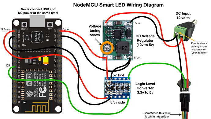

Ok guys. I searched and searched and finally found one circuit that I could extrapolate all but the 12v power supply. I just substituted a 5v at the point where the 5v emerged from the 12v to 5v converter.
And this is only for the WS2812b. My main question is: Can you simply parallel the data line to 2 strips? Or does each strip need a separate data line from the NodeMCU? If so, which pin on the NodeMCU should I use?
My second question regards something that seems odd to me. In the diagram I got off the net, up in the upper left corner, it shows a 3.5 OUT connection on the NodeMCU, going to a connection on the 3.5v side of the level converter. On the 5v side, it connects to the 5v at the 12v to 5v converter. How can that be? It appears both sides of the converter are getting power. Why would you convert 3.5v to 5v when the other side is already 5v? Can someone explain that to me? To me, this looks like a mistake. Could it be that 3.5v OUT should be an IN???????
Third question. Up at the top of the same diagram, it says "NEVER connect the USB and power from a supply at the same time". Does that mean that once you flash the NodeMCU with say the FastLED you need to remove the mini USB plug from the NodeMCU BEFORE you apply power to the NODE MCU??
Finally, I have yet to find any diagram whatsoever that shows how to hookup these same components to TWO WS2813 strips. Any help along those lines would tickle me pink! :slight_smile:
