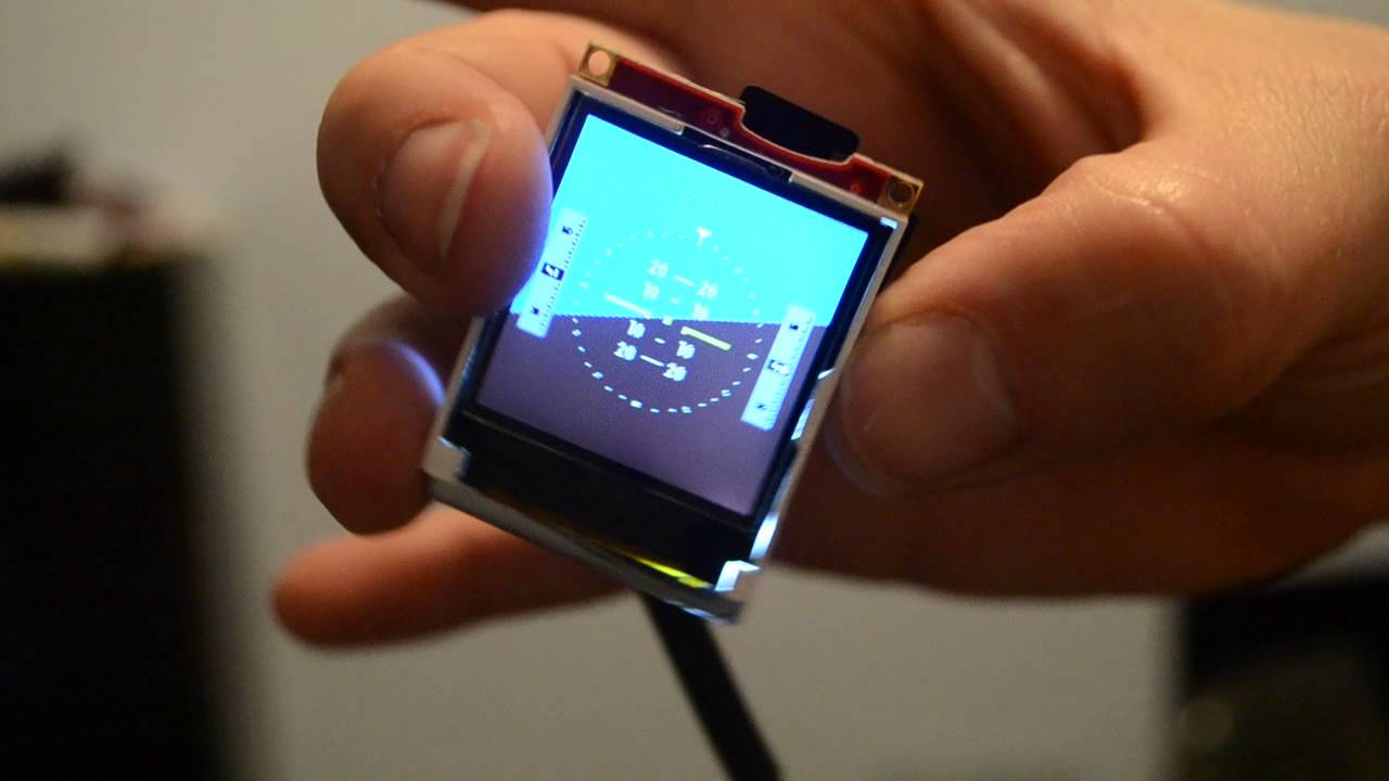

Hello guys,
i would lik to build a mini artificial Horizon display for a model airplane. the code should take roll + pitch angles from an MPU6050 and display an articial horizon "ball" similar to that of an aircraft. im using the SPI 1.8" display, and managed to build a static display of pitch = 0 roll = 0, similar to the attached picture. so far im trying to run the diaply with variable angles, without the gyro, just for making sure i have the display running well.
im using the Adafruit ST7735 library, and i can fill parts of the screen with tft.fillRoundRect function, but i can not get how to fill "angled" parts of the screen. i managed to get a code running just the Artifical horizon line using DrawLine:

but how do i fill the screen in color above and below that line? under that line should be brown, and above it blue.
also, in order to get just one line on the screen at all times, i have to "delete" the line by drawing a black line over it, this wont work with full color background.
basically what im trying to get is a code like the piece of code i added, but above the line all blue, under the line all brown.
any ideas? thanks.
i did try a for loop with a single pixel print, from 0,0 all the way up to the angled line, but it is very slow. takes about 2 seconds to fill a whole screen - and i need to refresh it at least 1-2 times a second.

If you want to display just "roll" angle, i.e. pitch angle is zero then:
Use trigonometry (Tan) to find the coordinates of the point at the edge of the screen of a line at the angle you want which passes through the middle of the screen. Since the middle of the screen is a known point this is easy.
Then reflect the coordinate to get the point at the opposite edge. Now you have two points and you can draw two filled triangles and two filled rectangles to set the above and below horizon colours, then draw a line at the horizon.
If you want to add pitch then calculate the coordinate shift on the y axis and the use this as the point that the angled line passes though and to get the intersection coordinates at the edges of the screen. You cannot use coordinate reflection is this case. so you must use trig to get the 2 end points of the horizon line.
If you draw it out on paper you will see what I mean.

fillTriangle() and fillRect() as hinted in post #5
Edit: If you want to make your code much smarter and hence quicker then it is quite easy to use the old and new angle coordinates to work out the minimum size of triangles (either 2, or 4 triangles where a corner transition occursl) that needs to be filled, this would boost the frame rate significantly for smaller/slower angle changes.

i would like the middle round to stay stationary, and the blue and brown background to move as AHI moves.
for now i will settle for automated movement, and can integrate actual gyro data later.
Even with my current sketch, if you move DrawAHI() to main loop, in order to refresh it, it is very slow to refresh, probably about 1hz and that looks bad as it blinks and fills the screen top to bottom. so im looking for faster ways to do it.

bodmer, i changed my code to use your library but i still find it being slow.
here's what im trying to do and what happens:
  1. fill the background with grpahics.
  2. print a AH line on the existing filled screen at a certain angle.
now, in order to refresh (change line angle) i have to do: 3. fill the background with grpahics. 4. print a AH line on the existing filled screen at a certain (different) angle.
i guess the screen filling takes some time, because this causes a lot of flashing and delay in the screen.
any ideas how to do this quickly without the flashing and delays? i did manage to print just the line, on a black ground, with a good refresh rate. but as soon as i add the background graphics, it all becomes slow.
Thanks for the video. A picture is worth a thousand words. A moving picture is worth even more!
As far as I know, the ST7735 can not display a separate foreground and background. Which means that updating the display is going to need some intelligence.
Either by redrawing each object that contains the "new" triangle. Or by reading the GRAM and replacing the CYAN or GRAY in the new triangles. Reading GRAM with an AVR is relatively slow.
I can do it both ways but it is fiddly getting the graphics to match. I will wait until Bodmer comes up with a better method.
