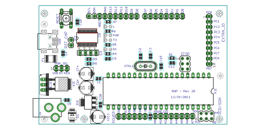

If there is interest in a '324/644/1284 style duemilanove, I think I have one ready to go:
Based on past experiances and lessons learned shown in past posting here and as implemented recently with the R3 release on the Uno board, should not all consider adding a diode from the AVR reset pin to +5vdc (cathode to +5) for any design using the auto-reset through a series cap function?

Lefty, what's the diode for? I haven't used that on any board and have not seen any problems.
Here are the eagle files if anyone would like to review/critique/suggest improvements.

CrossRoads:
It was a problem that a member here uncovered about a year ago and the thread ran for some length. The findings were turned over to Massimo and they in time implemented a change in R3 UNO. It's an insidious problem that can cause a sketch to lock-up under certain conditions after receiving a auto-reset pulse from the usb serial controller, and requiring a manual reset or power down/up to recover. It can be replicated on older as well as the current (pre release 3 UNO) boards. If you look carefully at the schematic of the newest release 3 UNO, you will see they have added a diode between the reset pin and +5vdc to eliminate the problem.
I think this is the original posting and investagation of the symptom: http://arduino.cc/forum/index.php/topic,64256.90.html
Bottom line, adding a diode can clean up a lurking problem that any AVR mega chip based arduino board using the auto-reset feature can experiance.
Lefty
CrossRoads:
Leo72 in the Italian forum suggested using a PIC something for the USB interface.
http://www.crossroadsfencing.com/BobuinoRev17/atmega1284_DIP_NoExtras.brd
http://www.crossroadsfencing.com/BobuinoRev17/atmega1284_DIP_NoExtras.sch
I think they are in Eagle 5.11 still.
The PIC we suggested is a PIC18F14K50, the same used for the MCP2200 chip: it's a micro that can be programmed to obtain, if necessary, other devices (like the Atmega8U2 or the Atmega16U2 of the Arduino UNO) but it is available in SOIC package too, so it can be soldered easily. Using the PIC there's another advantage: we can completely control the autoreset feature: we can activate/deactivate it, and we can send an HW reset signal to the Atmega using a pin. With a specific firmware, that a member of the italian forum has prepared, we can use the DTR signal instead of the RTS of the MCP2200. Last, but not least, we can have other functionalities available for further needs.
Bob, are these files freely available? Can we use them to derive a board?
No obvious problems to my eye.
