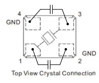

Your schematic says Y1 is a crystal, if so does it not need capacitors to GND on both sides ?

It is a 4 pin crystal resonator with built-in capacitors, only GND connection is needed if I got it rigtht from the datasheet .

According to the attached datasheet that is a crystal and it will need external capacitors. All my resonators are 3 pin devices.

You are probably right. I add 22pF capacitors between 1-GND and 3-GND. Thanks for pointing it out.
amazed
January 31, 2022, 1:31pm
14
Yes, I mean 22pF between 1-GND and another 22pF between 3-GND.
amazed:
1-GND and 3-GND.
Mind that there two GND pads/pins; both have to used.

I doubt it. They probably only connect to the case for shielding purposes...

As suggested in the datasheet by "‧Extremely good for reducing EMI effect.".
