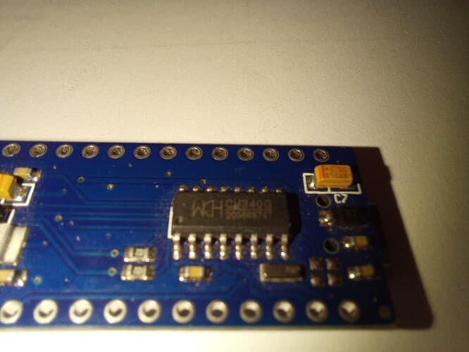

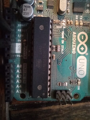

Maybe your confusion is where to start counting. All ICs have an indication where pin 1 is.
CH340; pin 1 is identified by the little dip (left bottom).
328P: pin 1 is identified by the little circle
328P: pin 1 is identified by the little dip (right bottom); note that the half moon matches the the top of your image (yes, I know it's a different chip).

The print on the chip (for dil packages) can also be an indication. Pin 1 is at the left when you can read the text.
