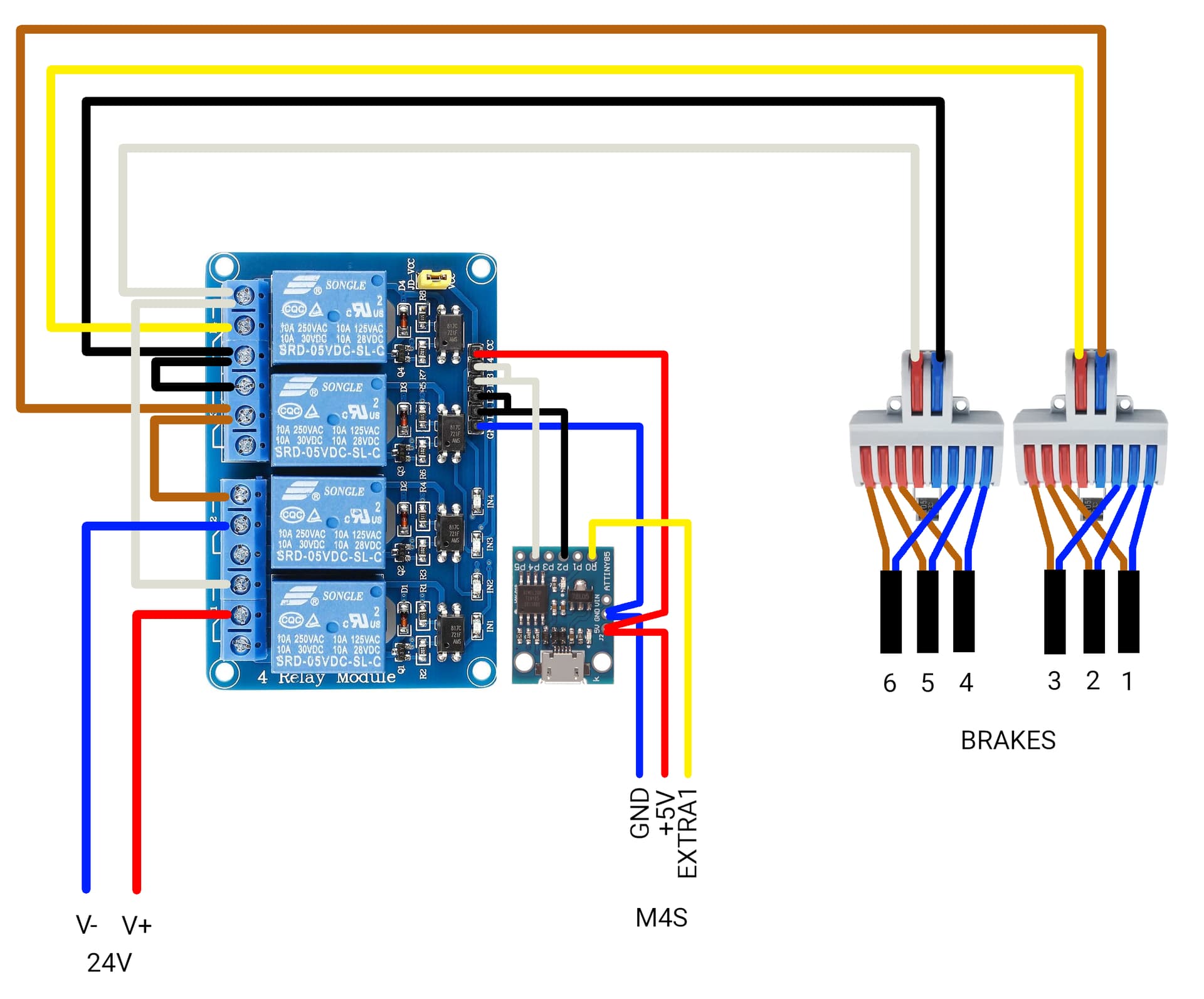

Tell us about your circuit, power etc.. The code you shared is straightforward and would not damage the chip by itself. The issue is almost certainly electrical or hardware-related.
➜ relay board does not have proper flyback diodes ?
➜ weak regulator, insufficient decoupling, or long wires with power supply to the ATtiny85 which dips or spikes when the relay engages ?
➜ relay module inputs expecting a heavy sink/source current (some boards need >20 mA on each input), overstressing the MCU's pins ?

Hi, @spuidley
Thanks for the diagram.

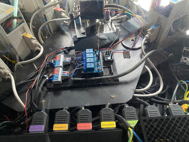

How have you got the project powered on the 5V side?
Can you post some images of your project?
So we can see your component layout.
Do you have flyback diodes on brakes?
What is extra1?
Place 100uF and 0.1uF capacitors in parallel across the 5V and gnd at the Attiny85 PCB.

Yes here is an image
No I don't have flyback diodes on the brakes I understood the relays had optical separation here is the link 1-5PCS 4 Channel Relay Board AVR 51 PIC 5V 12V 4-Channel Relay Module with Optocoupler Relay 4 Way Relay Module for Arduino - AliExpress 502
Extra 1 is the signal high from the m4s controller
Does that mean fit the capacitors between the live and neutral as in green on this picture?

Where does the 5V on the Atiny come from?
Since there is no feedback diodes on the brakes the Atinys might be damadged.
Is the Atiny chips hot when power?

You should use them.
And the way you power the relay doesn't take advantage of the optocouplers.
The 5 v comes from usb power through the M4s controller from the pc.
I have not noticed the chip getting hot.
It never fails during use, its always next time I turn on the pc and brake circuit.
I don't know anything about feedback diodes but I will learn.
