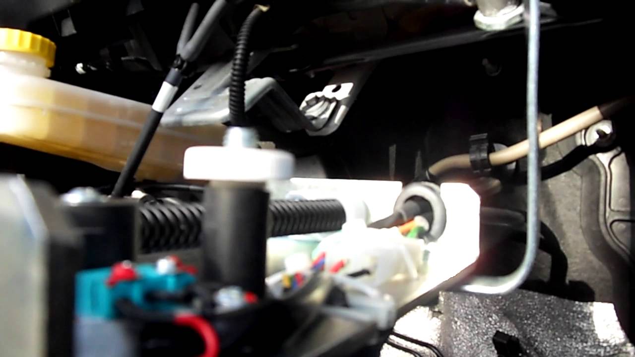

Had injured my left knee a few years ago. Clutch operation has been painful ever since.An automatic car is not within my means as of now. I am trying to design an automated clutch system for my car.
The clutch pedal has to depress when brake pedal is applied at speeds below 20kmph. When brake pedal is released, the clutch pedal shud come to the biting point. Touching the accelerator pedal shud engage the clutch fully. Braking at high speeds shud keep the clutch engaged until speed falls below 20 kmph.
The motor will be abt 100-150 watts. It shud have good holding torque to hold the clutch pedal midway at the biting point.
Can anyone help me design this?

To give you an idea, here is a video link of the product. Not available where I live.

Hi. Thanks for the reply. I have been trying to research the same but found limited info. I felt arduino wud be a cheap solution, which I can just junk if it doesnt work.

I'm also looking for the same. I am not an expert but I have the idea without details. I would like to share with you what I have in mind. Maybe I can help you the start your project and in return you could also help me when it's my turn to make it.
First thing first is safety. We need to make sure that when this device fails the clutch should work 100% by foot and would not stuck in any position.
Here's my idea. Let's start with the basic functionality.
  1. A push-button switch, an arduino, a stepper motor and a stepper motor driver. You can search the internet how to wire them together. Mount the switch on the stick handle. You have to options on how to move your clutch pedal...pull down using a cable or push down using a lever.
    For the code. It should be something like you can adjust the motor's speed, rotation and the right stop position.
    Here's how it works. When you press the pbswitch the motor would pull or push the clutch pedal down (depending on your set-up). When you release the pbswitch the motor will return to its original position and so does the clutch.
  2. A joystick, an arduino, a stepper motor and a stepper motor driver. This one is a bit advanced than the first one. With the same hardware setup you can control the position of the clutch based on the position of the joystick. There are lots of videos showing a stepper motor mimicking the movement of a potentiometer. The joystick is just a pot. You can control the clutch excatly where you would want it to be (biting point?) You could also add 3 LEDs (Green, Orange, Red or whatever color you like) that would let you know the position of the clutch pedal. Like green = clutch pedal is not pushed down, red = pedal is fully pushed down and orange = clutch is at the biting point.
Why stepper motor? IMHO this is the safest choice as it can hold its position when there's power but can be rotated with less effort when the power is cut. You can safely switch this device off regardless of the position of the motor/clutch pedal.
Be aware, never use a motor with worm gear as it locks up when the power is cut. It will hold your clutch pedal in the exact position when the device failed.
The other functions you need require multiple inputs to the arduino. I hope someone can chip in. You can also use rpm instead of speed.

Thanks. I will try it when I build my own. But it should be hand-operated with a joystick. Just the basic like this video.
