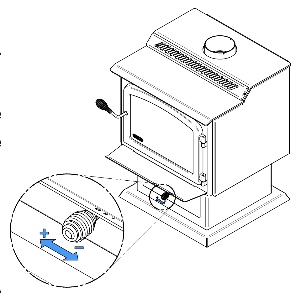

Hello everybody. I am new to Arduino and need some help to select the correct components for my project.
Anyone who ever used wood burning stove knows that you adjusting burning intensity by closing or open manual draft damper. To burn clean and efficient today we supposed to know chimney temperature and make sure we burn hot enough. As a result I have K type high temperature probe with digital display to see stock temperature. At 700°F air damper becomes completely closed and at 400°F completely open. That is recommended temperature range.
Wondering if someone did this before and can help me to choose correct components for actuator, display, control board. My wood-burning stove made with pretty large pedestal and it's empty inside. All kinds of room for linear actuator and rest of the components.
Appreciate any information that I can get.

And what is the maximum temperature that space will get to when you are using the stove?
In order to know what to use with the damper, you need to design the entire mechanism, including how you will mount the actuator motor.

I GUESS I DIDN'T MAKE MYSELF CLEAR ON THIS SUBJECT. MECHANICAL PART OF THIS PROJECT NOT PRESENTING ANY PROBLEMS AT ALL. IF I END UP WITH A LINEAR ACTUATOR WITH THE TRAVEL DISTANCE ANYWHERE FROM 2 TO 6 INCHES OR SO, I SHOULD BE ABLE TO MAKE IT WORK.
I NEED HELP TO CHOOSE CORRECT ELECTRONIC COMPONENTS TO MAKE IT WORK. SPACE UNDERNEATH THE STOVE IS STAYING RELATIVELY COOL BECAUSE OF CONSTANT AIRFLOW OF COMBUSTION AIR TO THE FIREBOX

My plan was to get needed components and try to make it work on the table with input from chimney K-type temperature probe. If I get it to work for me on the table, I will find a way to incorporate this to my woodstove mechanically without any issues at all.
This is supposed to be fully modulating application. Damper should be modulating open and close based on chimney temperature. At 700°F linear actuator should be completely extended (damper closed). At 400°F actuator should be in closed position (damper open). Or vice versa. Somewhere in between at 550°F damper should be open at 50%.
If Arduino Uno can do this for me, then this is what I will get. Any small actuator, step motor will be able to move this damper without any effort. But there is digital temperature display that will work with Uno? There also should be correct set up in between Uno and K-type probe?

You are correct about the on/off switching, but the Arduino is very fast, and by the selection of on and off times the output can look "proportional".
However, this has no relationship to your issue. You will be taking a temperature, converting/mapping that temperature to a desired damper position, and then stepping your actuator to that position with on/off step commands. Your code will create the proportionality between fully open and closed.
Thank you. This is a good start!
So, Arduino Uno with basic 16 character x 2 line display.
I will look into a 5 V step motor or linear actuator.
Will I be able to plug in my temperature probe directly into Uno?
No. You will need a K thermocouple signal amplifier like this
https://www.adafruit.com/product/1778?gclid=Cj0KCQiAq7COBhC2ARIsANsPATEb_wa5v6gbpPb9rsXTuwmRwk_PYQqZOeuc5sXjEC9Pt-RcUykNOvEaAvq-EALw_wcB
Thank You!!! Looks like I did get myself short components list after all!
