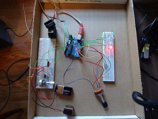

These are the two links i have found while doing research im thinking of a similar design. I have to do this as my final project now but i just need some guidance really on how to go about doing it. Thank you
