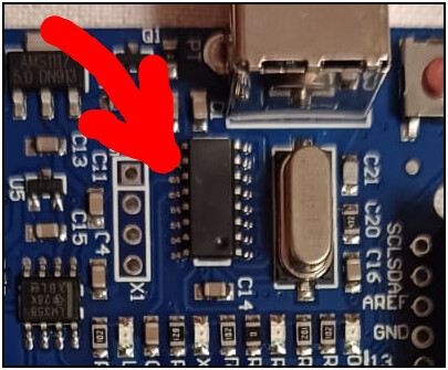

That is the first time i´m using th board...i think it is a UNO, but I´m not sure. I've tried to select other boards without success. The port selection is ok. But the error avrdude: ser_open(): can't set com-state for "\.\COM3" is displayed. And at the monitor of the upload I find the detail Avrdude: stk500_recv(): programmer is not responding . Any idea ?
Post a clear picture.

That is my board.
I can see that, indeed, your board has the dodgy "CH340" chip that is incompatible with the latest driver versions.
The CH340 chip normally has labeling that looks like this:
SparkFun - CC BY-SA 4.0 (cropped)
But the chip on your board doesn't have any labeling:
So just follow the instructions I provided and it should start working after that.
