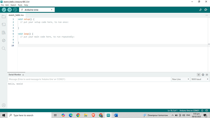

Let's do one more test just to make sure.

hello this is the result in the loopback test.
when I sent the message the TX and RX led flicked
