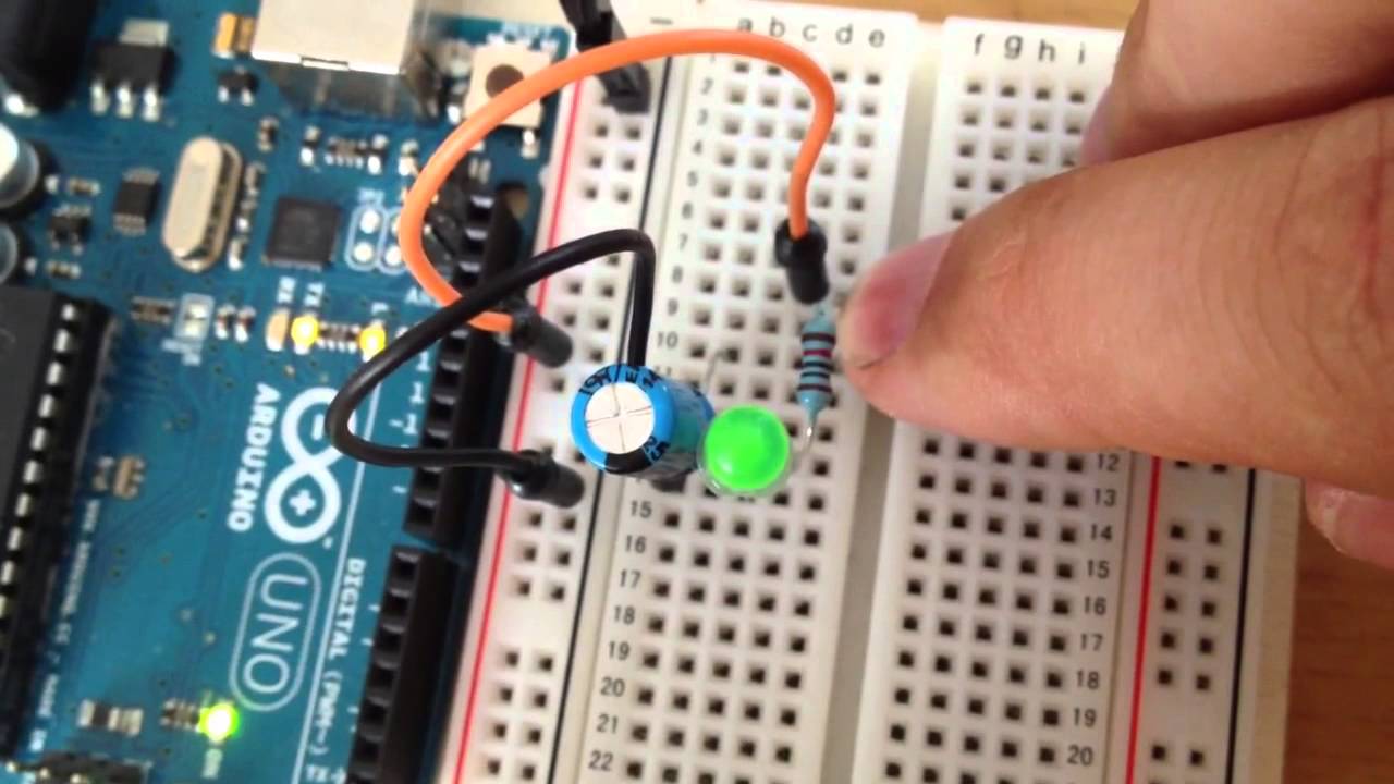

As an exercise in basic EE and basic maths, i want to fade out a LED with a capasitor. I wonder if anybody could peer-review my calculations?
Given i am using a 10k? resistor and a standard LED in series, and in parellel with a 100µF cap, all in a 5V circuit, shouldn’t my timeout be 0.76 seconds?

Now that the day is drawing to night, and it's getting darker, i can empirically see that the 0.76 seconds is too short a time for my LED's fadeout; it seems to be above 1 second.

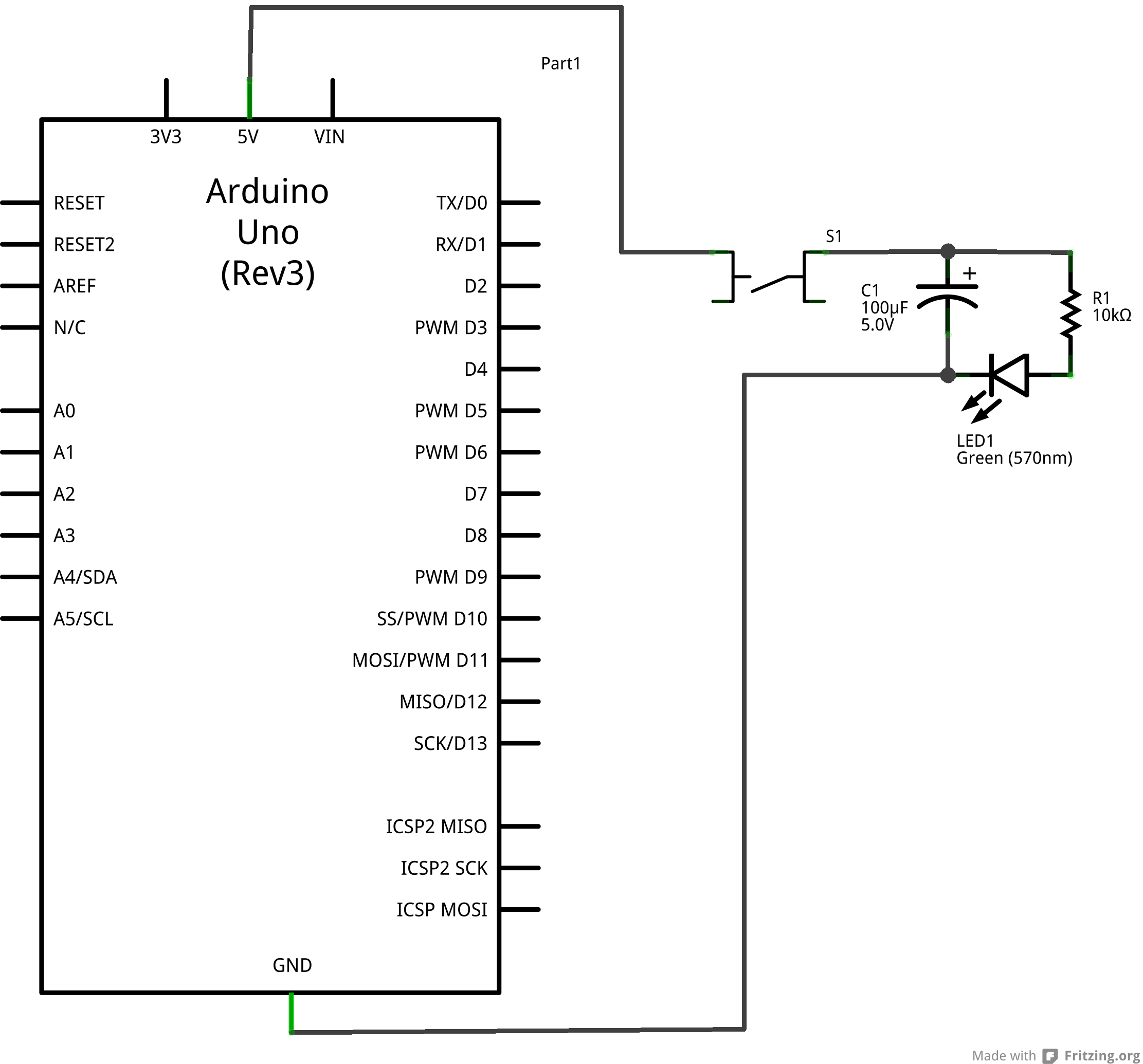

The circuit schematic is too far away, but let me guess : The capacitor is in parallel with the LED. The switch is in parallel with the LED. The resistor is not used.

@AmbiLobe: Do you mean how my circuit was built? The resistor was used; the cap is in parellel with LED and the resistor, which are in series together. See the attached schematic.

The RC time constant is 1 second.
Thank you for the schematic diagram. The math is like this after the switch is released: There are three nodes : S1 Anode GND The LED Anode has about 2v as a diode drop. Treat it as a voltage source of 2v. The resistor has 3 volts time = t = 0 seconds The peak current at t=0 is i(0) = v/r = 3/10k = 0.3mA The current decays exponentially
i(t) = i(0) * e^(-t/rc) rc = 10k * 100uF = 10^4 * 10^-4 = 1 second e = 2.7182 a constant from science education
e^-1 = 1/e = .632
e^-2 = 1/(e*e) = .632 * .632 = .40 e^-4 = .16 e^-8 = .0256
after 1 second i = .3mA * .632 = .189 mA after 2 seconds i = .3mA*.16 = 48 micro amps (uA) after 8 seconds i = .3mA*.0256 = 8uA
Conclusion : your math was wrong. The LED will be dim with .3mA. Its power is 2v*.3mA = 0.6 milliwatts This is a dim bulb.

You short the supply into the capacitor - add a small value resistor in series with the switch if you want to avoid welding it shut and resetting the Arduino!

Oh, so it’s not good to let caps suck in energy as they please, without controlling it? As explained f.ex. here. Hmm i guess (V=IR) if at the beginning time t0 the voltage jumps to 5V, the resistance is (theoretical) 0, then the current is infinite, until the capasitor starts to build resitance as it’s charge increases. Is this it?
