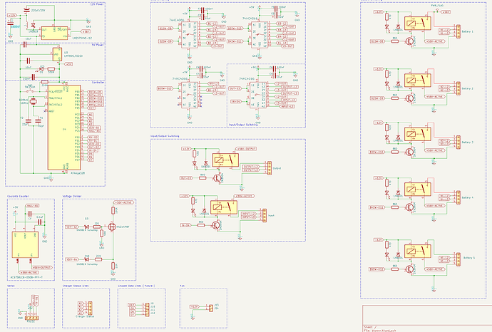

A very rough sketch. My first time using KiCad so the lines are a bit of a mess.
Im sure I probably have some things in the wrong place.
I still need to add in the hall effect current sensor and the indicator lines from the charger.
However, I am interested in any initial feedback of if something like this would be workable?
I have cleaned up the sketch if anyone has any thoughts?
Great job, I do not think my fifth was that good.
Nice, neat schematic, well done!
For your next attempt you can improve it by following the rule of positive voltages towards the top, negative towards the bottom, signals in on the left and out on the right.
Fuses and batteries
You have fuses for the batteries next to the relay contacts; the main reason for using fuses is to protect the wiring from the high currents possible if there is a short circuit. All but the smallest batteries can produce sufficient current into a short circuit to heat wires enough to start a fire, this is particularly true of lead acid and lithium batteries. Placing the fuses where you have them does not protect the wiring between the board and the battery. I would place the fuses as physically close to the batteries as possible. For a multi-cell battery I would place the fuse in one of the wires linking the cells of the battery.
The schematic does not show the batteries themselves, so I can't see what is going on there. What are the middle 2 connections for and how are they connected? I see they go to the 4066s. The 4066s are powered from 5V, which means they must not have a voltage outside the range of 0V and 5V applied to any of their inputs. As I can't see where these connections go I can't see if this is the case, but given that they are 56V batteries I suspect there will be more than 5V on 4066 inputs.
Although the BJTs you have operating the relays will work perfectly well my preference would be MOSFETs.
The 470Ω resistors for the LEDs will give about 20mA through the LEDs, I would guess this will make the LEDs a bit too bright, it might be worth experimenting.
Voltage divider:
IRLZ14 is an N channel MOSFET. An N channel MOSFET conducts when the gate voltage is sufficiently positive of the source to turn it on. How much positive depends on the actual MOSFET. In the case of the IRLZ14 it has an on resistance of 0.2Ω with Vgs = 5V. In your scematic you have the source connected to +56V and 0V or 5V on the gate, it is never going to turn on. If you are switching a positive voltage you need a P channel MOSFET combined with either an N channel MOSFET or an NPN transistor to control the gate. I'm not going to propose a circuit for you, this kind of thing comes up a lot and there are examples in this forum and all over the internet.
I don't know what the 100nF capacitor on the gate of the MOSFET is for: it will just make the MOSFET switch more slowly, not withstanding that it won't switch on at all, see above comment.
I don't know what the 1n47xxA diode in series with the gate is for; all I can see it doing is reducing the drive voltage to the gate and thus slightly increasing the on resistance.
Your voltage divider has 100k in series with 1.5Ω, giving an output of 0.00084V, which you are not going to be able to measure.
Serial port
You don't normally need a 5V connection for a serial port, Tx, Rx and ground are usually all you need.
Decoupling capacitors
While I can see some you also need them close to each 4066, and anywhere else I might have missed where something is fed from 5V. If in doubt add another decoupling capacitor, there is no such thing as too many decoupling capacitors! (Awaits someone making a cartoon of a board covered in decoupling capacitors).
Relays
I think this might have been covered elsewhere, but relays capable of switching 56VDC reliably are not common and not cheap. Interrupting DC at anything above about 24V is difficult with mechanical contacts because the arc that starts when the contacts part does not self extinguish. With AC the current stops 100 times per second (in the UK), which interrupts the arc. No such thing happens with DC.
Thanks for the feedback. I will work on those changes.
Thanks I will move the fuses
The batteries are EGO 56v 10Ah. They are sensor lines. The battery will discharge without these being connected but the battery charge indicator does not update. Also some devices require these to be connected to operate. Eg if I don't have the sensor lines connected on a leaf blower, it kicks in for 1 second then stops.
I also need these lines for when it operates in reverse so the charger can know the state of the batteries.
I don' want to mess with the charging or discharging, the whole point of the board is to allow the charger and loads to operate normally just by "swapping" the batteries out with the relays.
Voltage divider
Yeah I need to redraw this section. I have a working version on a breadboard but I realised I copied it over to the schematic wrong in my initial design, because it was a mess.
Being lithium batteries I don't think the voltage divider will be of much use anyway because of the drop off curve but I will keep it in for testing.
I am using an external serial to usb controller. It is just matching up the lines required on the board. These will only be used for development
Good point I will add these
Relays
Yep I found some that work and they aren't too expensive, ~$3 each.
They can do 100vdc @ 30a. https://www.digikey.com.au/en/products/detail/picker-components/PTRH-1A-12SF-X/12318044
Thanks again.
This tells me very little. My concern is that the voltage on them might be outside the 0V to 5V that can safely be applied to the 4066s, you need to check this and confirm the voltage range on these connections.
As for the rest, when you have a new schematic please post it. It might be worth waiting a little while to see if anyone else has any comments that might change things.
I think it’s single wire serial 3v

Updated version
  • Fuses removed. I'll add these to the battery terminals
  • Caps added to the 4066s
  • Cap added to output of the 12v supply
  • Fan connection added
  • Voltage divider redrawn
The idea of the voltage divider was to only measure the voltage I request the voltage. However I just calculated that it would probably take around 800 days for this to drain the battery, so I think I just leave out the switch to keep it simpler.
