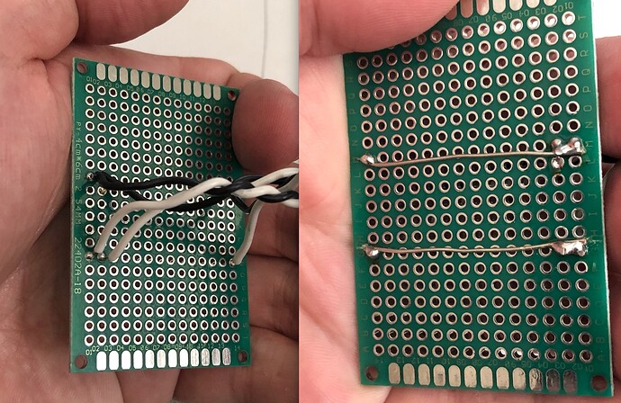

Best part to solder a bunch of wires together?
This seems like it should be simple, but I'm not sure what hardware to use to create a power distribution block with solder connections instead of screws. I have 8 components that need to be powered from the same source, and they are permanent installs so I don't want any chance of a screw coming loose.
I've tried two kinds of prototype PCBs. The first was only printed on one side, but each row was connected. This was ideal, except that the board wasn't sturdy enough. If I moved the wires too much it ripped the pads right off of the PCB. The second prototype PCB was much sturdier since the solder goes through to both sides of the PCB, but each hole is individual so in order to connect the wires together I have to use another wire or globs of solder. Any suggestions?

Show us the mess.
Always strain relieve and soldered connection so that the solder joint cannot flex. Fix the wires to the board with wire ties, twine, hot glue, ...
I don't have a completed one to show but I attached the obnoxious way I'm trying to do it now. It works but seems sloppy. Strain relief is a good tip I should've thought of but didn't, so thanks for that. I'm using solid over stranded because it's so easy to work with. Acts just like legs on a through-hole component, and fits the holes perfectly. Maybe I should consider stranded, but I only currently have solid wire to work with so I'd have to order some stranded.

If you have a few wires that are to connect together: each through their individual hole, but solder them to the wire next to them. No need for extra wires or blobs of solder, just a bit more wire to go through the hole.

Point taken on screw terminals. I found some that'd work, but they're higher cost than the prototype PCB I'm using now and don't save me much on time compared to my current method.
It looks like I might be best off using my current method with the strain relief a few of you mentioned, using longer wires to connect one hole to the next. I thought there'd be a commercially produced PCB or connector for this type of thing, but that doesn't seem to be the case.
I do like the idea of looping the wire through from one side to the other, as it adds strain relief and also helps hold the wires while I solder them.

Actually searching for "stripboard" turned up something that looks like it might work. This has power rails that are connected, it is double-sided, and the holes are through-plated. It even has screw holes to make it easier to mount in an enclosure, so it looks very promising. I'm going to order some and try it out.
