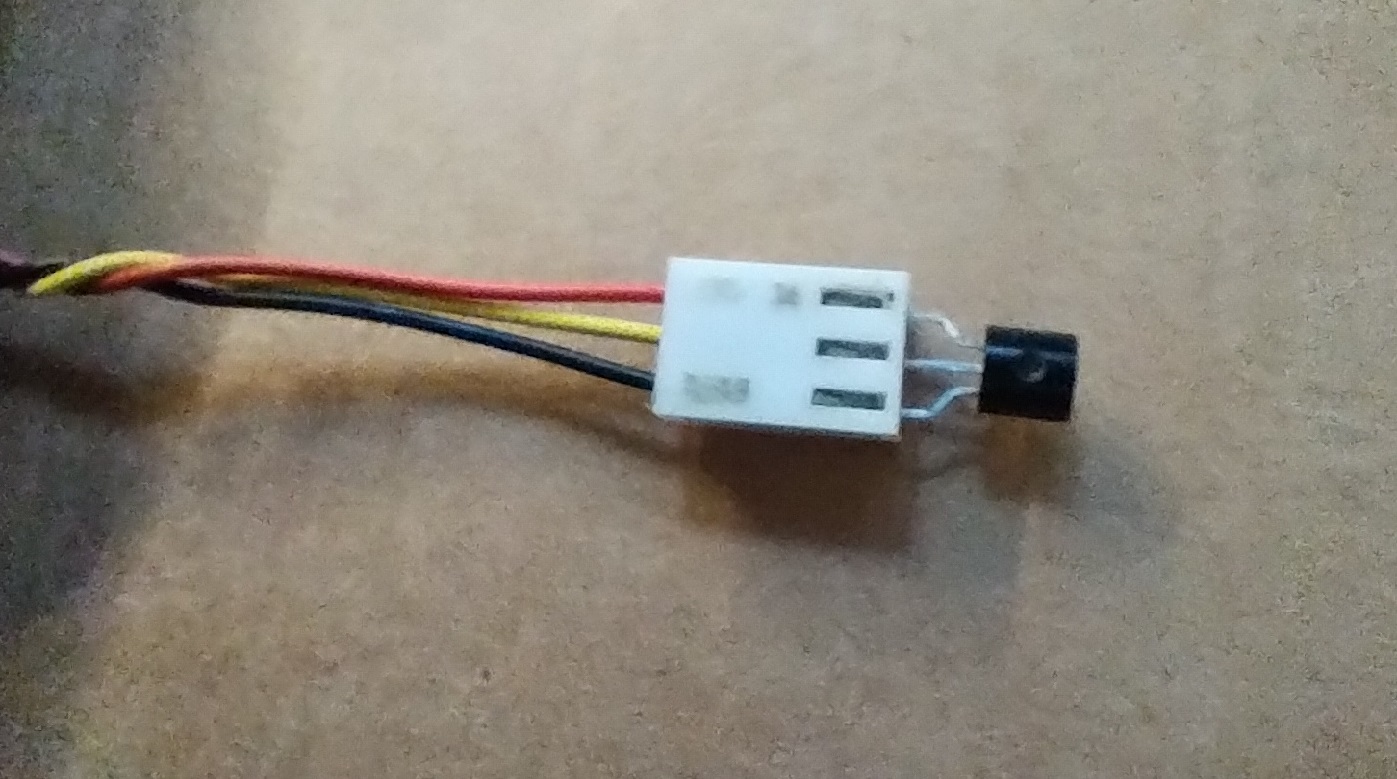

Hello!
Please advise what is the most simple and convenient way to connect multiple ds18b20 sensors to a 3wire cable? I mean what type of сonnector to use instead of soldering it?
Thanks,
Hello!
Thanks,
I've used Molex 2.54mm KK connectors with DS18B20 temperature sensors.
Other makes of similar 2.54mm/0.1" connectors are available.
