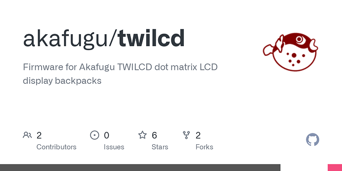

Oh....I almost forgot to mention that, as with the 40x02 displays, you WILL NOT be able to use the run-of-the-mill i2c / SPI character LCD backpack boards to simplify the addressing scheme from the controller board to the display itself. Most of those top-out at 20x04.
However, Akafugu does supply an imminently capable TWILCD backpack board here:
TWI protocol libraries for Arduino and avr-gcc are available here:
AllanGH:
Well, so far at least, 40x04 is the largest LCD character display that I've seen available to the consumer/hobbyist market. If somebody out there is selling something larger, I'd be interested in seeing tech specs on the hardware.I presume that, because of economic forces, and the limitations of 4-bit / 8-bit address lines, the next logical step up would actually be an LCD or OLED graphics display panel; which would, of course require more resources from the host micro-controller board.
https://store.akafugu.jp/products/33
GitHub - akafugu/twilcd: Firmware for Akafugu TWILCD dot matrix LCD display backpacks
