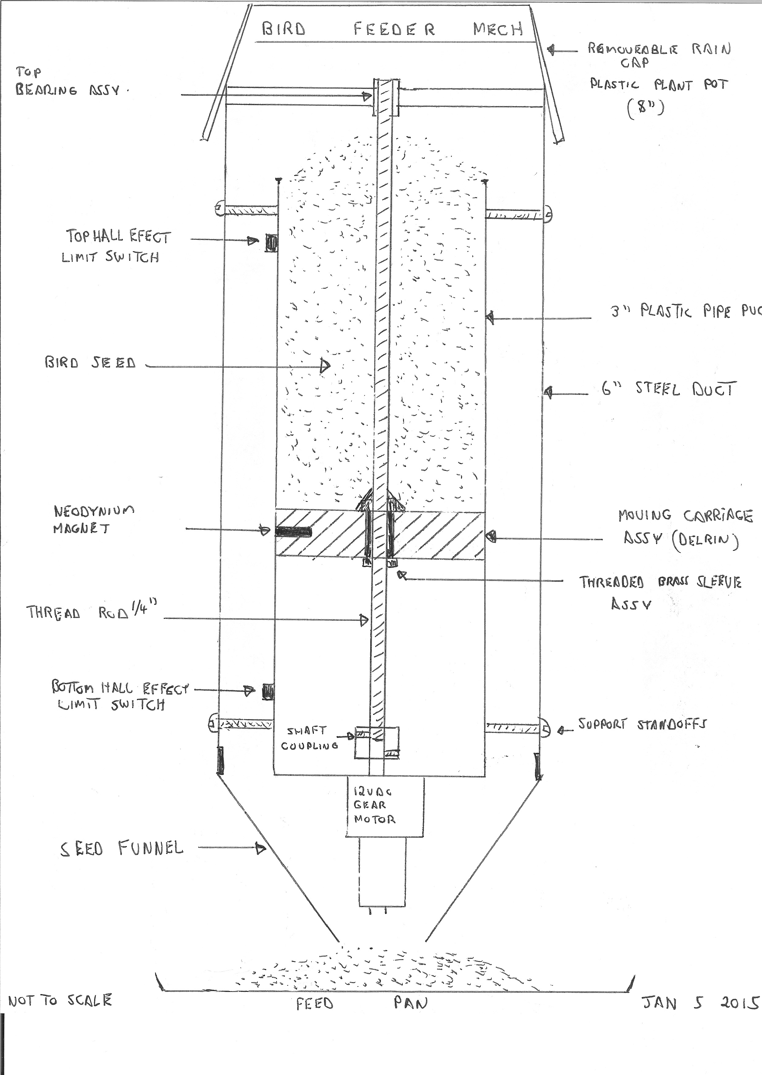

I was wondering if any of you Arduino gurus could help me and or code a sketch for a project I am working on. It is an automated bird feeder which will dispense a set amount of food once a day (by time or light) until it empties at which point it will automatically reset itself and wait for more food to be added and a reset button to be pressed which will start the feed cycle again. I have already built and tested the feed mechanism hardware to do this so now all I need is the brain to control it and figured / assumed the Arduino could be perfect for this. The only problem is I am a rookie with regards to the Arduino (and microcontroller programming in general) so I will need a lot of help as really I am still at the LED binky programming level.
Mechanical Diagram
Please See attachment

Whatever you do, squirrel proof this bad boy. Those rodents are mighty smart.
I made an almost identical version to dispense peanuts.
You might want to put some thought if it should dispense anything if there is food at the bottom already.
Why not just have a gravity feeder :wink:
you should look at remote via the nRF24L01.
good range and low power.
plus two arduinos = twice the fun!
