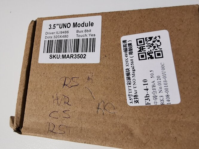

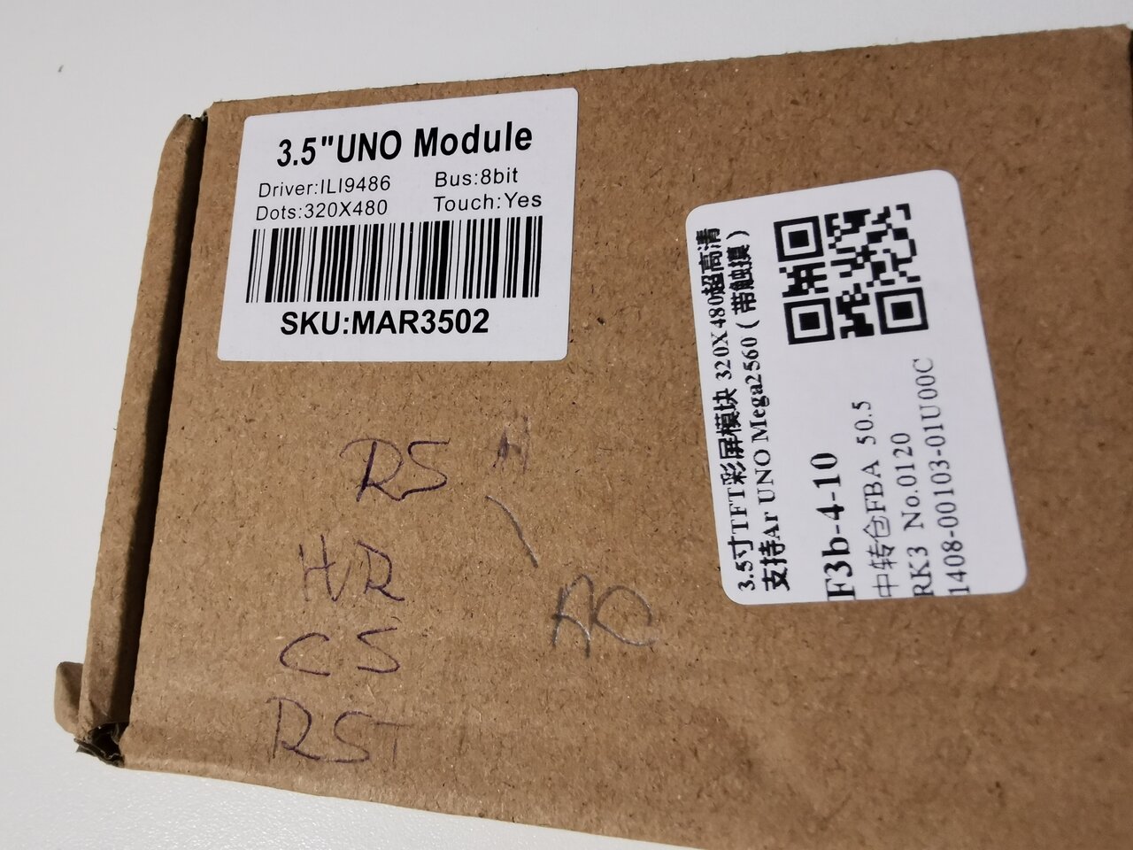

I have a Mega 2560 board, and I bought a 3.5 tft lcd display from wish where they wrote that it compatible with UTFT library and has an ILI9486 driver.
After trying at least 5 or 6 libraries with different driver setup, all I can get is a blank white screen.

Pictures from the display and its box are attached.
Thanks for any help!
It "looks" like a good Blue 3.5 inch Shield.
The box label says ILI9486
The LCD_ID_readreg.ino report does not show the values that I expect from ILI9486.

You show "real life" photos in #0. They clearly show a pcb with a Parallel TFT. And a label that says ILI9486.
LCDWIKI is famous for its bad spelling but ST7735S refers to a Sitronix 132x162 controller with an SPI interface. Yes, it is available with a Parallel interface but screens are normally 1.44 inch 128x128 or 1.8 inch 128x160.
Since you get "unexpected" values from LCD_ID_readreg.ino I would just assume your controller is BROKEN.
An Ebay shop will normally give a full refund immediately. There is no such thing as a "partially working" screen. So a "part refund" is not applicable.
