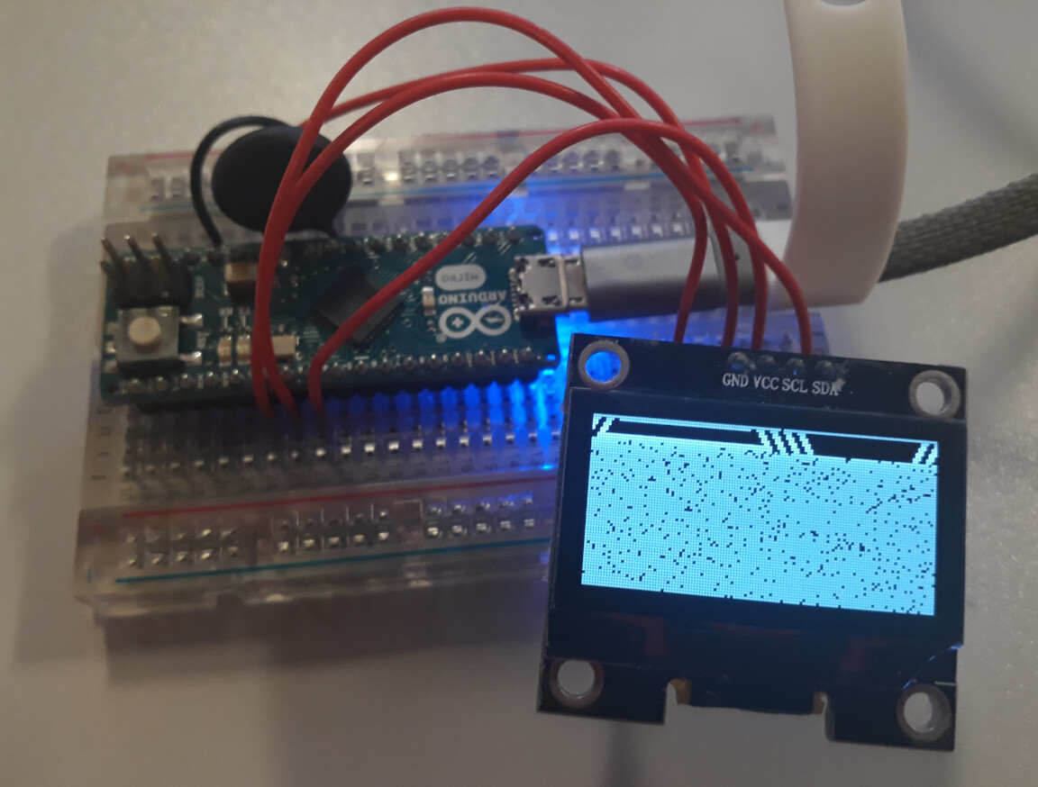

Hey guys, I am running a little 1.3" OLED screen off of an Arduino Micro, and am having trouble getting it to display properly, which I am not sure is down to either the display being broken (salvaged display), me using the wrong Arduino variant or maybe just down to bad programming.
Attached is a picture of the issue I am having with the screen, where it wont display using the full screen, instead it only uses the top 10ish rows of pixels and leaves the rest of the display looking strange.
I am running the 128*64 I2C example from the SSD1306 library (posting the code exceeded the character limit)
Anyone have any ideas or have come across something similar before?
Not familiar with OLED screens with bad timing etc. But is there a simple example code you could run to make the code less of a possible source of error?
Honestly not to sure if there are pull up resistors there, I cant tell just from looking at it, and cant seem to find a datasheet online. Have attached a picture of the back of it in case it is pretty obvious.

This was the simplest example I could find, it seems to be what a lot of people use as an example to showcase the screen as well.
