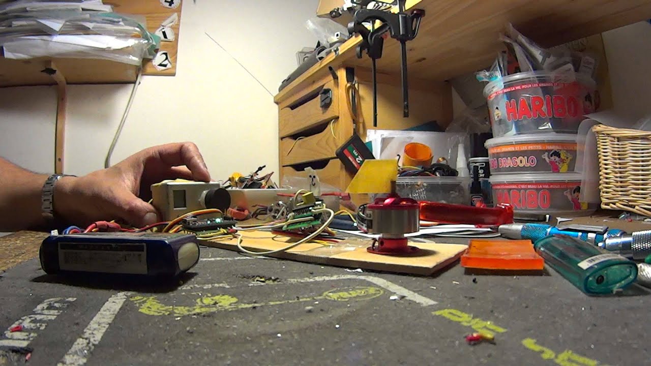

Brushless motors are usually 3-phase and come in two main varieties - sensored and sensorless. All the brushless motors for RC aircraft, quadcopters etc are sensorless, which means a special controller is needed to determine when to commutate the windings using the
back EMF on the 3rd (unpowered winding). They are also very high current motors, way beyond the capabilities of a L293D (think 10 to 100A),
designed specifically for very high power density and running from LiPoly batteries via a matching ESC. Such motors cannot run slowly as
the back EMF is insufficient. Quality is variable, prices are cheap.
The other sort are sensored BLDC motors (extensively used in industry), which have hall-effect magnetic sensors to commutate even when
stationary - these motors are designed for running for decades reliably in industrial environment and are usually superbly engineered and
very very expensive as a result. They are often the basis of industrial servo motor, where an encoder and feedback circuit controls the motor
to allow fast accurate positioning (even more expensive).
How if we not use ESC and use L6234 IC? like this guy:
and this guy too:
