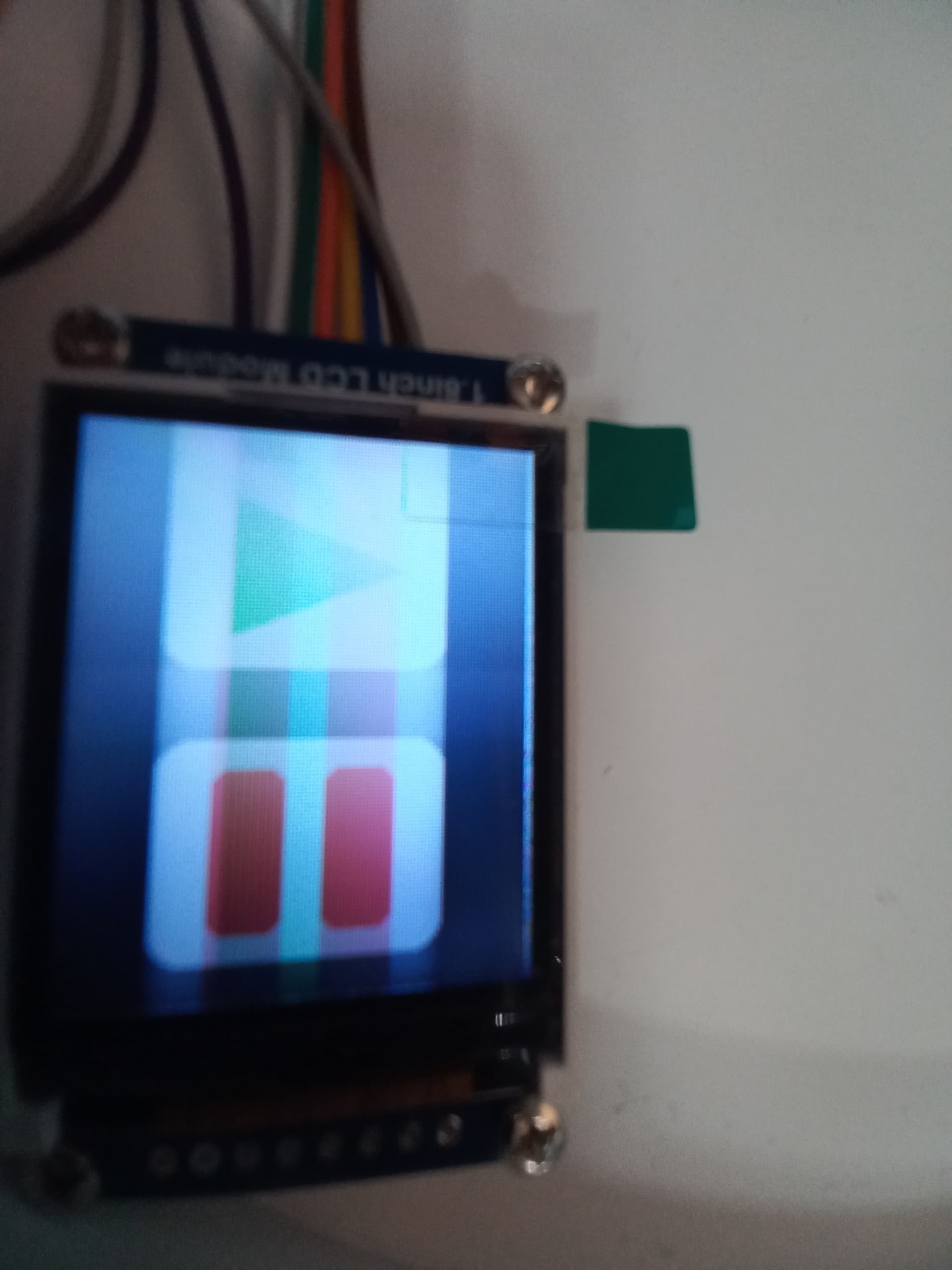

Recently i got this display:
I downloaded their library (Adafruit-ST7735-Library) and flashed "graphicstest" example to my Arduino UNO board. The display is wired as follows:

According to some tutorial I should get something like this:
But my display looks like this:
The gradient of the background isn't caused by the camera, it's really visible.
Similar result comes out of default Arduino TFT library. It shows something, but it's deformed like this. I tried using my Arduino Nano too, but there was no difference. I hope that I didn't damage it in some way.

Please post a link to the actual screen that you have bought. e.g. ebay sale page.
There are many different makes of 128x160 or 132x162 TFT controllers.
And several makes of the physical TFT panel.
Most importantly, all TFT controller chips require 3.3V logic. None of them are "5V tolerant" according to their datasheets. But ST7735 seems to survive.
I suggest that you use level-shifters or resistors on the logic signals if you want to use a 5V Uno or 5V Nano.
When you use 3.3V logic, choose the appropriate "initR()" argument. e.g. your photo shows a "GREEN TAB". But it is not an Adafruit product.

The library said that for my model (1.8 inch ST7735) i need to use "BLACK TAB".
And both, Waveshare manual (https://www.waveshare.com/w/upload/a/a2/1.8inch_LCD_Module_User_Manual_EN.pdf) and the example from the library didn't say a thing about 3.3V logic. Could 5V logic damage my display?
I found that the Waveshare display needs some kind of offset, and it should use "GREEN TAB". It helped a bit, but still the display looks pretty much the same.

Well, the good thing is that my screen isn't burned out. It works with my RPI without a problem. I have no idea why it's not working with Arduino. I'm going to rewire everything and try again.
Success! I got it working. It turned out that the 5V logic level was the problem. And with Waveshare, I needed to use "GREEN TAB" initializer. Thank you for help.
