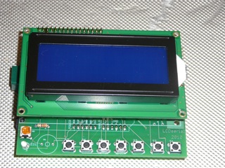

I built a 20x4 LCD shield a few months ago. I made 10 boards. I plan on revising the board and selling them.
http://www.cbxdragbike.com/arduino/serialshield/index.html
If you are interested, let me know
Mark
