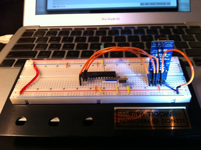

So what am I doing wrong? Don’t know if you’ll be able to see well enough with these two images. I’m still getting the programmer not responding error in the IDE. I have the board set to duemilanove /w 328. The ATMega328 on the board has the blink sketch uploaded already from when I was using my actual arduino to program it. What I am ultimately trying to do is make a really simple board that I can use to program the 328s. I don’t need something really exciting, just something that I can solder up on a small PCB and use when I need it. So I’m trying to make sure everything works properly while it’s on the breadboard then I will wire it up. I have everything wired up according to CrossRoads’ post. I cut the jumper, added the jumper, etc. Still getting programmer not responding. Any suggestions for next troubleshooting steps? Thanks
The CTS signal from the FTDI friend should not go directly to pin 1, it should go to pin 1 through the capacitor. So in your photo, move the jumper one row, from row 39 to row 40. Then move the capacitor to go between row 40 and row 39 (pin 1 on the AVR).
Also add a 10K resistor from pin 1 to +5.
I realized I was using a 22pf cap not a 0.1uf. Do you think that is the single cause for the 328 not responding? The TX LED on the FTDI friend blinks when I upload a sketch, and nothing comes back through the RX LED, is that expected? Also, shouldn't I be able to manually reset the 328 right when the IDE says Uploading sketch xxx of xxxx? I was able to when it was on a breadboard and was using my actual arduino to program the chip. Any suggestions are appreciated, I'm trying to learn as fast as I can!
Here’s an image of what I have currently.
That looks better now, and yes the cap on the reset pin will need to be a 0.1µF. Is it still not working? And yes a manual reset should work as you describe, just add a normally-open pushbutton switch from pin 1 to ground.

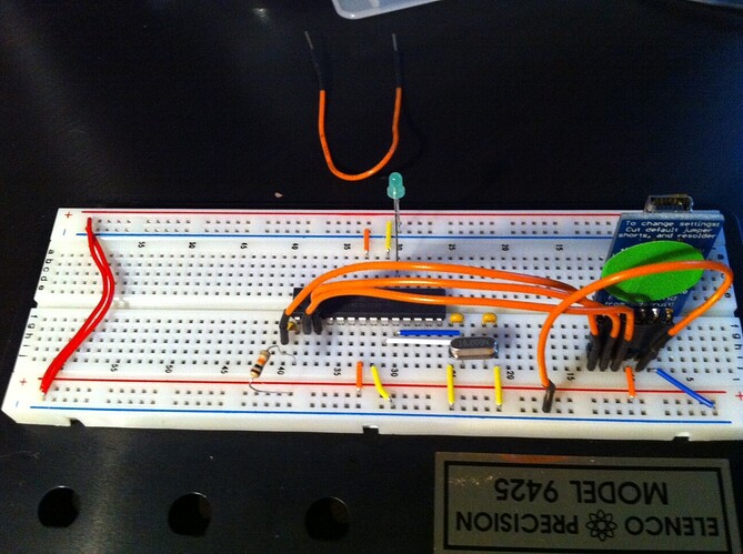

So I made sure I've got the 0.1uf between pins 7 & 8 and one between pin 1 and RTS on the FTDI friend, compared my circuit to the breadboard helper eagle files, everything looks good. When I upload, it seems to be resetting, because I have the blink sketch already on the ATMega328 and it cuts out mid blink and restarts the sketch. The TX light on the FTDI Friend blinks when I'm uploading, but I never get any blinking on the RX LED.
Any other suggestions?! I had everything working fine when I was using an arduino as an isp, but I'd love to have a standalone programmer. Thanks for all the help
Did you cut the RST jumper and connect the DTR pads on the FTDI friend? All I see is green felt there. Wires are in the way in the first picture. Also, put a 100nF cap across the VCC/GND pins, 7/8 and 20/22.

Yes cut it and resoldered, here’s a few better pictures. And yes the capacitors are in the right place, and I am using the correct ones now (0.1uf) I also tried using a standalone power supply in case the voltage was dropping, while uploading.
You don't have 20 & 22 connected to power & ground.
You also need a current limit resistor in series with your LED, otherwise you'll smoke the pin.
I did have them connected, I had removed them momentarily and forgot when I took the picture. I put a resistor in for the LED, didn’t think it would matter much other than burning my LED out quicker. Any thoughts on why all I get is programmer not responding errors?

Ugh, sorry guys. It was my IC :(
I probably burned it when I was trying to troubleshoot what was causing my problems. The good thing is, I learned a lot and I really appreciate the help. Do you think people would find it helpful to post a tutorial on how to build a really simple programmer using an FTDI friend?
