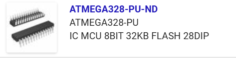

This is the chip I am trying to burn:
This is the DigiKey order:
Seems this is a case of its not a P type given its marked PU and Looking around on the web I found this mentiond a few times ;
" base model ATMega328 (no suffix) and the ATMega328PU, both of which yield a 0x1e9514 signature instead of the expected 0x1E950F "
You have the ATmega328, not the ATmega328P (the pico power version). You wanted
You can still use the ICs you have. Use the MiniCore coreplatform, and choose the "328 / 328A" variant of "ATmega328".
